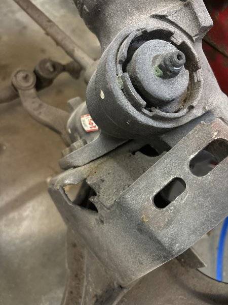

Crack near steering box 65 K Frame
DanDokken
2:58 PM
Sep 5, 2022
133
241
Oneida NY
Has anyone encountered this?
Chunk missing near PS Box
Dan
Dan
Something really hard hit that really hard to enable a chunk to be blown off. It is best to address this before it puts any unnecessary stress on the rest of the steering linkages. As far as welds, factory welds on the K's were scrappy at best.
My best guess is that it was made that way. I have seen pictures of others that look like that.
Who knows what caused it. Clean it out, vee the crack, weld it all up and box it in.
