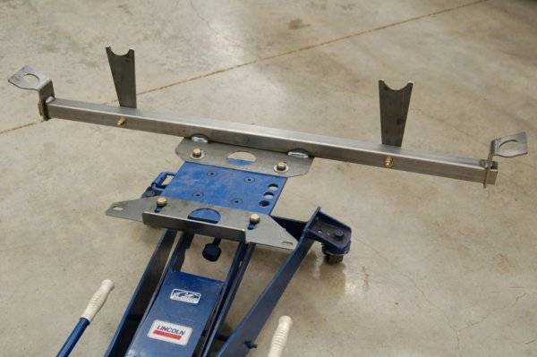

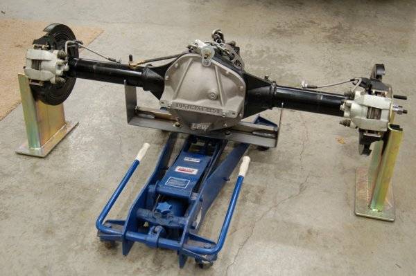

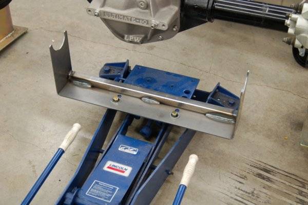

I put this cradle together so I could safely install and remove the Dana 60 from my car. I tried to do it with a floor jack but it was just too unstable. With this cradle bolted to my trans jack the rearend is very stable and I can control the placement into the car.
