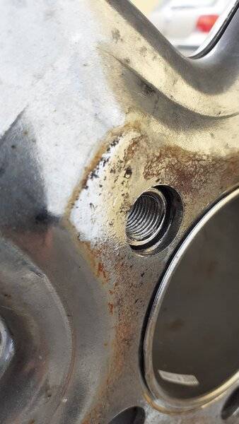

Got a set of used Cragar streetstars without lugnuts. Bought the recommended lugnuts with washers, but unsure if it is the right ones with enough lenght?
Does this look right?
Those look good to me. If the lug nut was the same length as the thickness of the rim how would you tighten it. Since the lug has pull down room I'd say they are good to go.
Yup. The end of the shank needs to stay about 1/16 to 1/8 in the hole when the nuts are torqued. Seen many mistakes made with a too long shank. The nut tightens but against the drum or rotor face leaving the wheel loose. Not good.
Not sure about the Street Star model. The lugs I got for my Super tricks extended into the inner half of the wheel, but not beyond.
