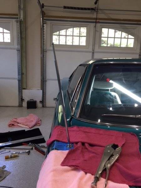

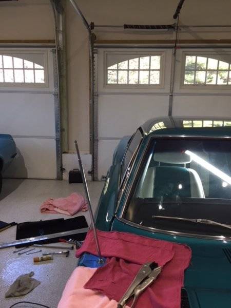

The antenna on my recently purchased GTX was not stock so I bought a reproduction from Classic Industries. However it stands crooked. Has anyone had this problem?
Loosen the thing up and spin it to see if it will sit straight like you'd like then re-tighten. Good Luck
it seems to me the mount is too far inboard. cant exactly tell by the pic.
You were right! The fender ring looks uniform but it is not. The lower flange must be on the inside. I spun it as you suggested and the antenna is now straight. Thanks!
