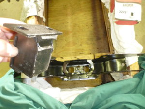

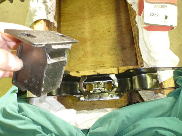

I have both of these, from what I can see, the "bigger" one is for a 70 b-body but will take a 69 A833. The smaller of the 2 is for a 69 A833, but it looks like part that goes on top is missing? not sure it is complete and ready to use. Can anyone confirm that?

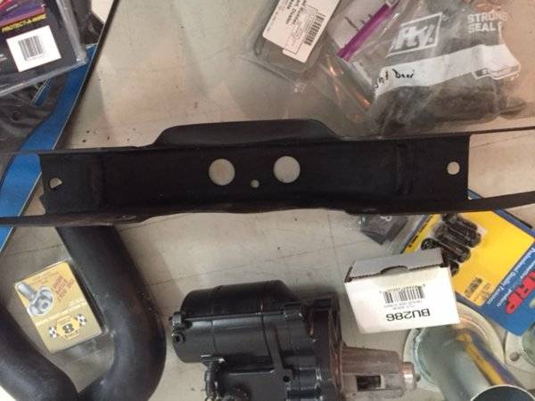

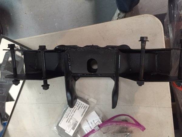

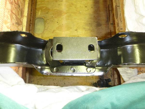

The one on the right is correct, but yes it appears you're missing the top metal plate and you need the rubber mount of course as well. Here's mine, '69 Bee x 383Mag- 4 speed - Lynch Rd car.
Ran across this when I went to install a '70 + b/e body 4 speed in my '68.
I had the one on the right and needed the offset pad one on the left - but here's
the kicker:
the through bolts for the older one are larger diameter.
Brewer's to the rescue - they have the one on the right with the larger bolts to work
with late '60's cars like mine. :thumbsup:
