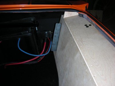

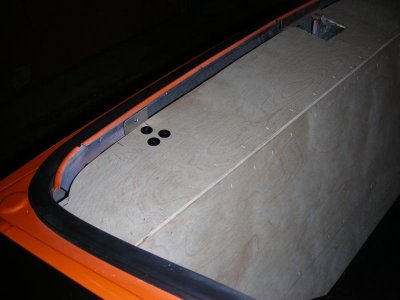

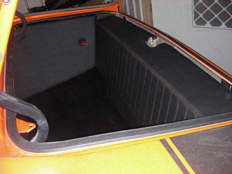

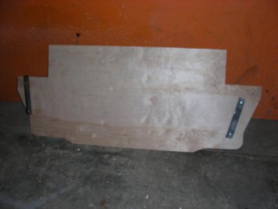

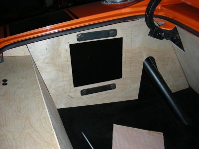

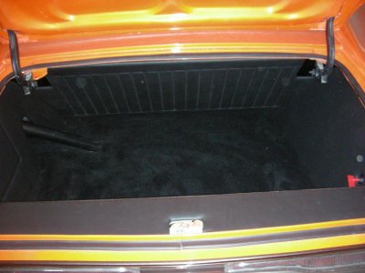

Here's the pics I promised, it's not done yet so I just laid the parts in there for the pics. I need to go around with black paint and touch up the overspray in areas and get it all fastened in. No boom box, just walls that are pleated to match the seats.

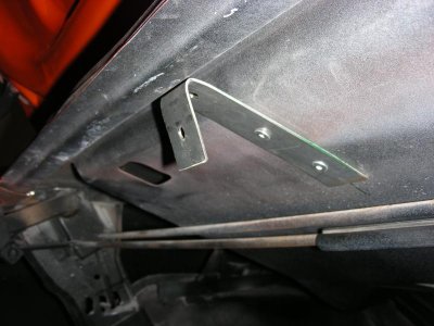

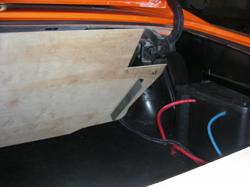

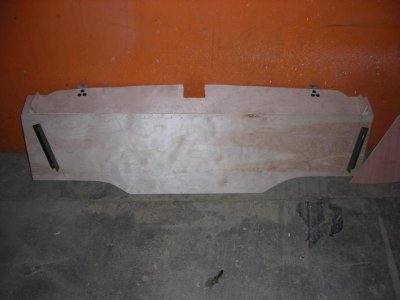

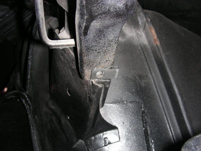

For fastening it in I wanted the least amount of screws and holes in the car and no holes in the floor so here's what I did. I made the forward panel so that it bolted to the trunk hinge bracing and to one bracket in the top center of the trunk opening. Then I bent some brackets that get Velcro wrapped around them to hold the side panels in.
The rear panel just bolts to the top like the factory one did and the side panels wedge it in where the bottom can't move. This one get's Velcro as well.

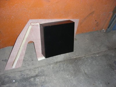

Here's one of the sides, I went ahead and made a storage area in the driver side and the passenger side hides the battery. These got Velcro sewed into the backs to stick to the brackets I made on the front and rear panels.
Sorry about these pics, I've got the car up on jack stands trying to finish putting a tranny in so it's hard to get good pics (that's my battery disconnect key hanging out).
I'm not to thrilled with some of the things the upholstery shop did. He was supposed to make a Velcro flap that coverd the hole under the gas filler neck and instead up removing the storage box and neatly tucking the material under it he sprayed his F'ing glue all over the inside of my freshly painted box and just glued the material to the inside as well (looks terrible):angryfire: I'll go back and repaint it, redo the box opening and clean it up.
