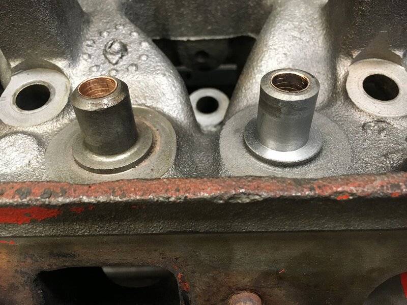

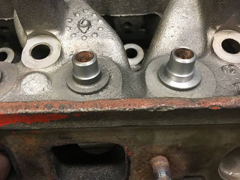

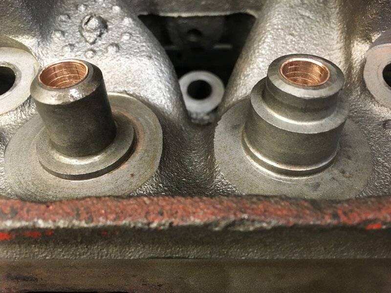

The 452 heads have the gigantic intake guide bosses.
I usually trim that away and cut for posi seals.
3EA4049C-208F-44C9-976B-C7875B3FD216.jpeg 0AE95269-0AFA-47E1-90EB-E45703A781C9.jpeg 0C152381-3754-4C60-9496-6372832210A6.jpeg
I believe they are too tall for the OP's application also. They were for mine. Those springs might not go over the guide bosses either IIRC.
I shortened the ones in the pic........ there is enough room for .700+ lift now.
The chunky intake boss doesn’t fit inside the height mic, so to avoid any headaches with set up, I pretty much always cut them down.
