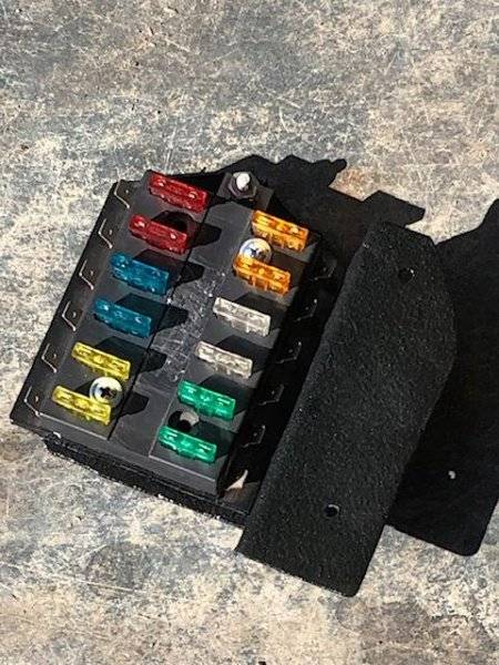

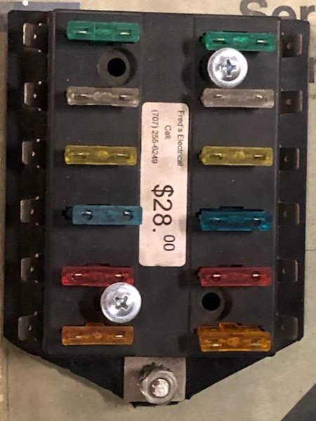

I installed an aftermarket fuse panel.

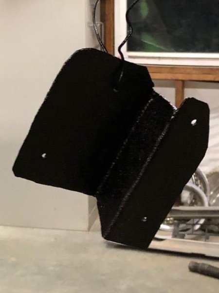

I made a bracket to mount it below the glove box, close to the RH door hinge pillar.
This panel has a constant power side and a switched power side. I have a vacuum pump for the brakes that runs to this panel along with the trunk latch, stereo, auto dimming rear view mirror and A/C clutch. The power running through it goes through a relay.
