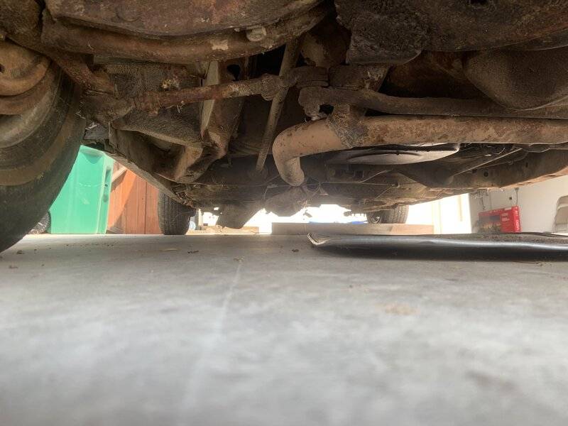

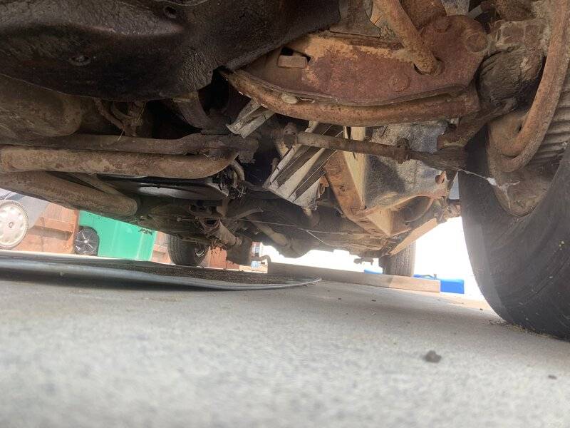

Hello everyone,
My Charger has a damaged frame rail.
I need to take it to a frame shop soon.
One is a picture of the damaged rail and the other is the good rail.
How bad do you guys think this is?
I am no expert myself, but maybe some of you have dealt with damaged frame rails before.
I also have thought about trying to find a frame rail from a different car.
Are the different frame rail or the frame shop bad ideas?
Thanks!
That looks like physical damage and rust from what I can see. You'll have to determine how strong it is.
The only bad frame rail I ever dealt with was decayed from the top, due to years of battery acid leaking.
I never noticed it when I bought the car, (E body). At some point, somebody disguised it with body filler and spraying undercoating (plus dirt and dust) on both rails. Eventually, the tire wear and alignment that wouldn't adjust properly, since the rail was flexing, that's how we found it.
Live and learn. When I'm looking at a potential car, I use a magnet and screw driver to prod those trouble frame areas.
I have no pics, it was years ago and 11gran, after the "while I'm at it" mentality took over. I bought the frame piece and a shop did most of the work.

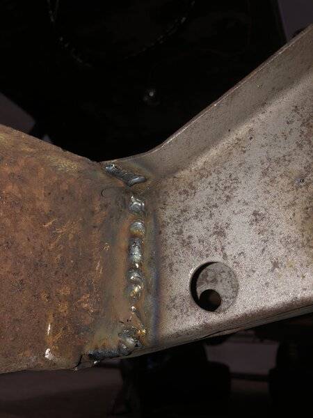

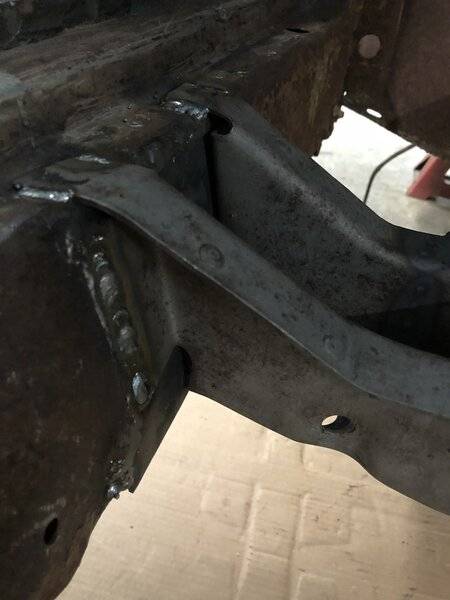

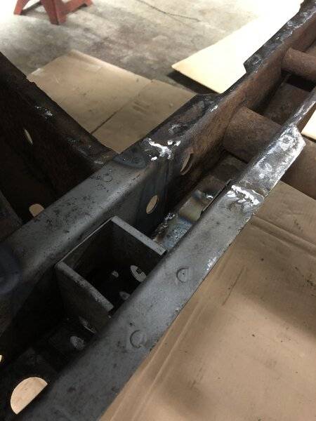

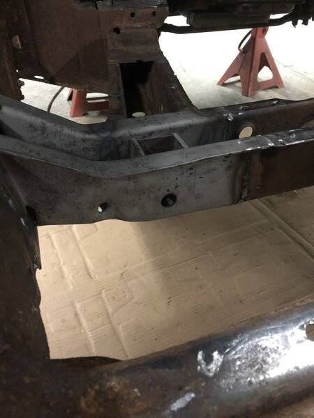

I did this…
Since only the end of my crossmember was soft, I bought this end cap from Derrick Fettig, a well known seller of western steel. It was $50. Since my front to back subframe and the rest of the crossmember was good, I cut the bad end off, made gussets for inside the frame, cleaned everything very well and welded in the new piece. I also gusseted the rocker behind where it’s welded.

I did this…

Thanks for posting your method and pictures. Your post is very helpful. Looks good!
