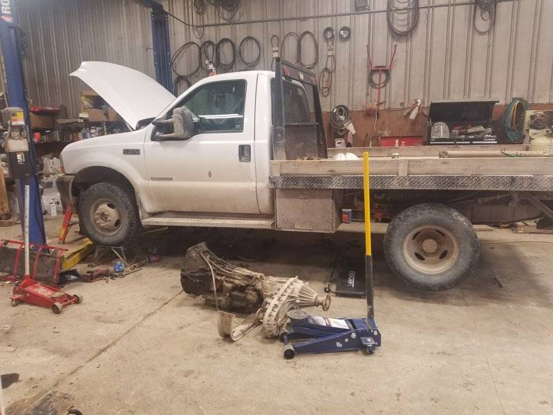

Monday the tranny in my F350 finally **** the bed on me. I bought thus truck 5 years ago from a welding shop where I get my supplies. Good people they sold it to me dirt cheap because the tranny was going out. Changed the F&F, added 2 quarts of Lucas and it got by for another four years of farm duty.
I really need this truck (7.3L) 4wd for spring duty so I spent today dropping the tranny. There's a shop 40 miles away that will have one rebuilt by Friday.
This has been a good vehicle, has 290k on the odometer. I complain only for the couple typical Ford reasons.
Too many of the bolts required twelve or. Metric sockets. When ordering a different tranny and sensors there were too many variations, so I couldn't get the parts ordered until I had them in my hand. And then there was this:
There are not torque converter bolts, just torque converter studs, 6 of em. I foresee this being a pos when it comes time to reinstall.
Any suggestions?
Hold it up to the flywheel before putting the tranny back in. Figure out the position it needs to be and put a paint mark on the flywheel and tq so you know how it needs to be oriented on installation.

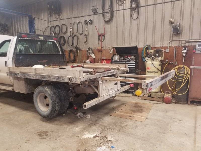

Handy truck.
The previous owner were good fabricators, made the flat bed. The hauled 20 foot sticks of angle iron with it.
The bed has a telescoping platform with lights. And a 40 gallon fuel tank.
