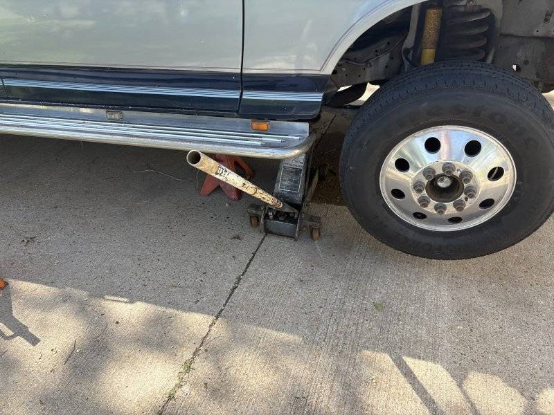

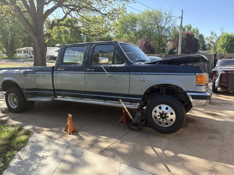

Now, just 38 years later, it is stuck under my F350!
Won't release to allow it to lower.
POS!!!

The teeth get worn down between the shaft and the cylinder valve.
Reach in there with a long driver and bump the cylinder release teeth.
Just don't be beneath it when you do it.
