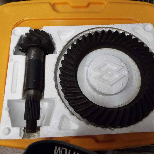

I have a 4:10 richmond gear set that is make for 4:56 and up carrier . It is a thin ring gear . pn # 82-7325-1 . I picked this up when Herb Mccandless was closing down his shop . It was used in a dodge they took to California to race ford vs chevy vs dodge . Then it was taken back out and put on the shelf . This would save you the cost of a new carrier housing . $100.00 plus the ride . John
Ha! I was just going to comment that I thought they had made those. Problem solved.
