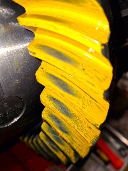

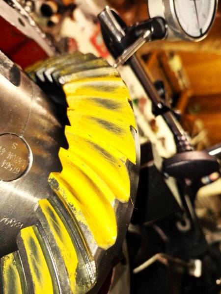

As a newbie, I had a lot of "fun" dialling in these Motive gears for my Dana but learned a heap in the process. I got to this point with mockup bearing/races where I think it looks decent.
Its going behind a 572 Hemi, approx 800HP/750 TQ.
Pics can be difficult to judge from.... Top pic Coast, bottom pic Drive. Carrier is a Detroit Locker 35 spline.
BL is .010" at different locations around the ring gear, was shooting for .010-.011". Preload is 14" lbs on used bearings with no seal.
Need some experienced eyes for guidance on the pattern...what say you guys ?
Thanx
Drive:
Coast:
