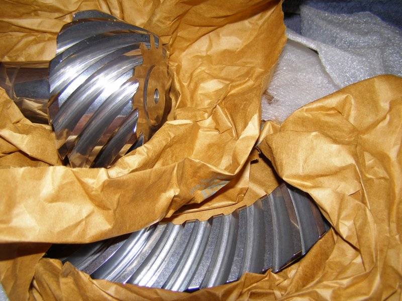

Actually, yes I do.
And I wasted no time getting one. It is going in my Mag Dana 60.
I had it superfinished, next it is out for Cyro and then install.
