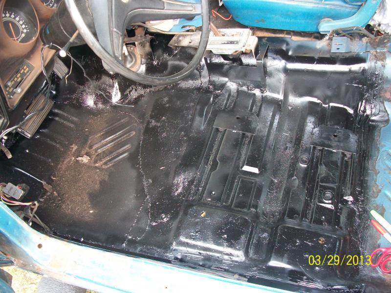

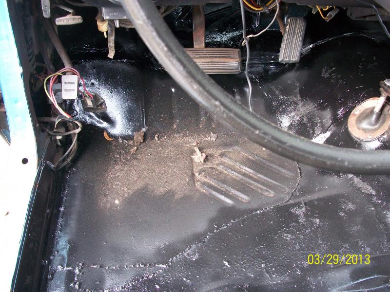

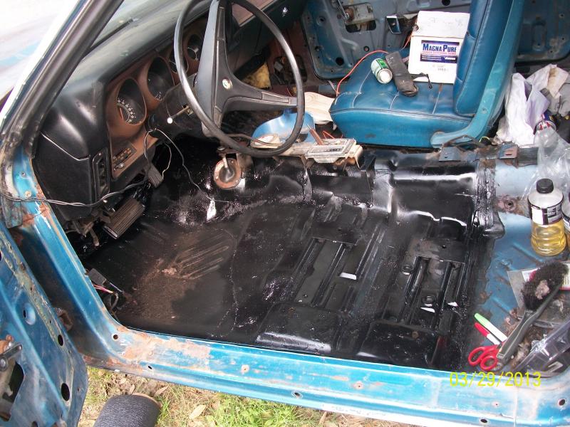

As you all can see my ol man cut my pan too short so i had to rig the bottom half. but i think i did okat my 1st time doin something like this!

Cover it up with carpet and undercoating neighbor,it will be ok.
Looks like a great project and the finish of your floor doesn't look bad at all! like said, but i would grind down the welds, just to make it look purdy lol, then paint/undercoat it all.. "oldman"? son, you'll be there someday, you don't want your daughter calling you old man when she takes the keys of that Mopar away do ya? :)
