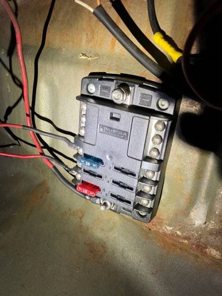

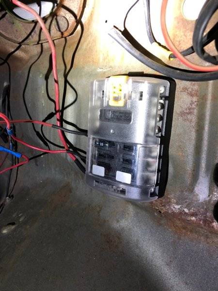

I added two Blue Sea fuse boxes to my Dodge Demon. All of my accessories are driven off of one of them, one is keyed 12 volt power (I used the original radio power feed) and one is battery feed 12v. My Demon is more race car than stocker. I however will likely do the same to the 73 Charger I just added. I use with 6 circuit one with cover and ground/negative.

This is the battery powered one, it is fed off starter relay.
I added the 12v keyed box to eliminate this and to add power for my Dakota digital fan controller.

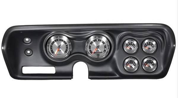

Dunno what you got in mind for the Cluster but there is an aftermarket solution for us. Everything depend on what you got on mind. They are offered in Black, Silver and Carbon fiber finish. Several vendors of these including the set of gauges at your prefference ( on $900-1200 rate depending on gauges ). Since you have the radio on console, this could be a nice add and still keeping some fashioned stock look

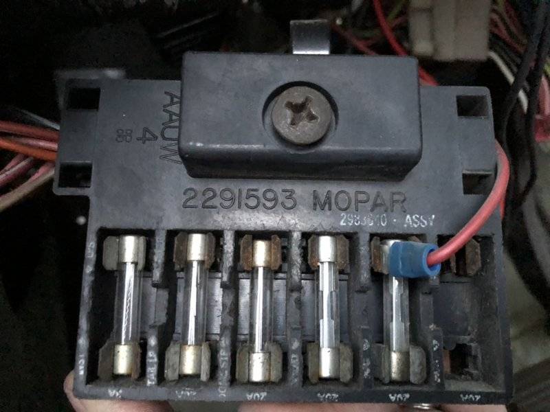

I believe the most basic upgrades, wiring wise, would be relays for the headlamps, swapping to a volt meter as opposed to the factory amp meter (or insulating the amp meter lugs if applicable), and bypassing the firewall block. Mopar Action wrote a good article on this several years ago, if I can find the issue I'll post which one.
@Nacho-RT74 yes i got the classic dash bezel already, Carbon Fiber one, plan on putting 3M vinyl (wood) over it to match what i'll do to the rest of the wood trim. As far as the gauges go, i had a good experience with Dakota Digital on another car which really helped when i sold it (guy loved them). These are the ones I'm going to go with, definitely the Sniper EFI mod, maybe the 2x fan controllers...
Universal 6 gauge cluster -http://www.dakotadigital.com/index.cfm/page/ptype=product/product_id=1088/category_id=69/mode=prod/prd1088.htm
