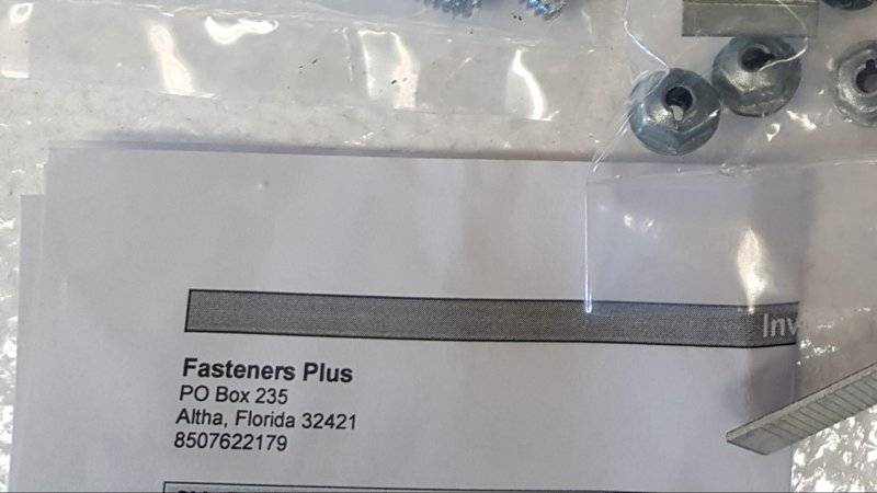

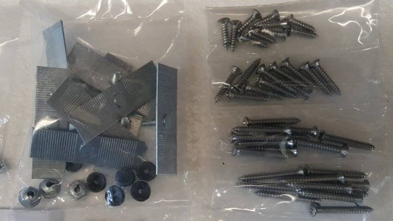

I found some stainless screws on ebay that are really similar to what was used. There's a seller that specializes in different trim screws. A lot of screws that are used have a smaller taypered head than the threaded part. So you need to know the screw size and the head size when ordering.
This is the outfit I found on ebay.
Thank you but the screws I'm talking about are a fine thread and are not pointy. I forget the exact thread size of the ones I need but those you linked to are pointed and the sheet metal screw type.

You need machine screws and that company should have them. Find a screw that works and measure it. Then look them up.
