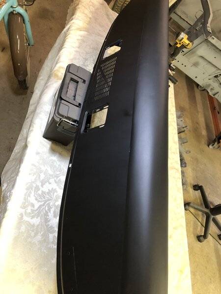

Who has installed the plastic dash cap before? i cant afford a reproduction pad right now so this is just temp.. i was pre fitting it and it fits great except around wood grain on passenger side,, being an overlay i wouldn't think that needed to be removed, but possibly just trimmed around?

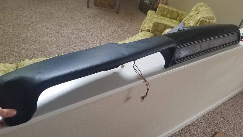

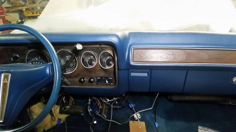

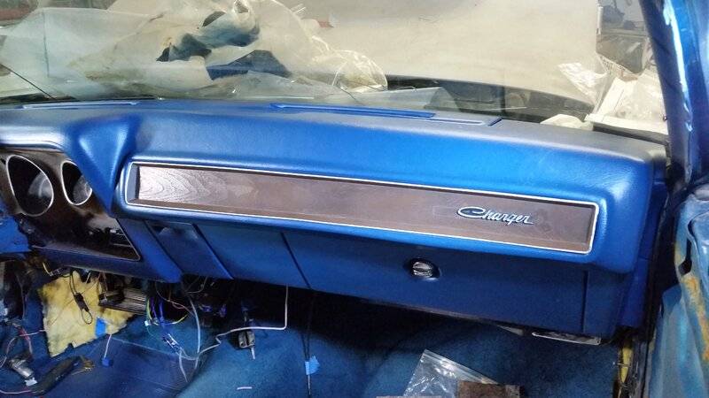

I used Bondo Jelly followed by Metal glaze to make it smooth. Then to give it some texture I experimented with flat black paint and a mini-roller. Gave it a pretty cool texture. You can see a little of it in the pics.

I hated the way the plastic cap felt and looked so I never installed it. I got $20 worth of soft vinyl from Joann's that matched pretty well, some high strength 3M spray adhesive and a heat gun to recover the dash. Its not perfect, but I think its way better than the plastic cap. If you arent willing to pull the pad out of the car, its hard to go this route.

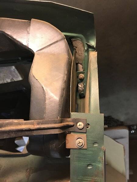

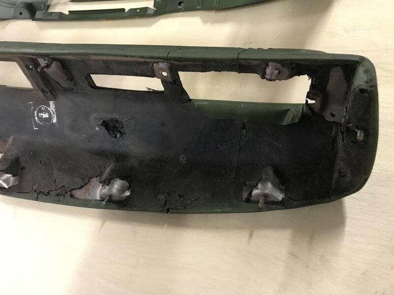

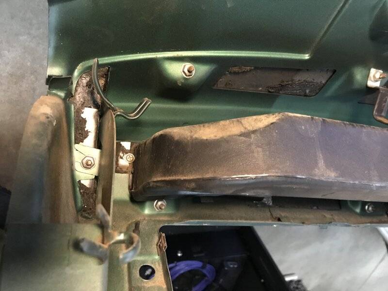

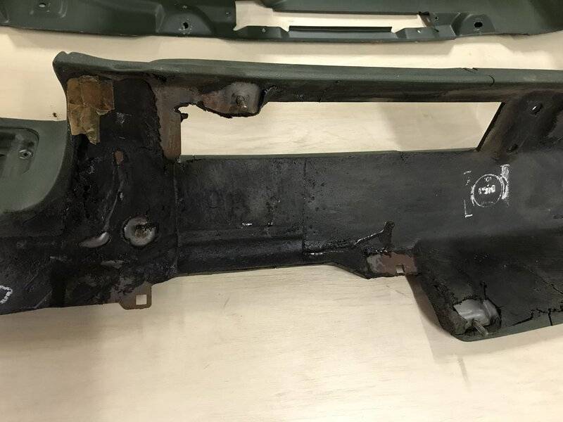

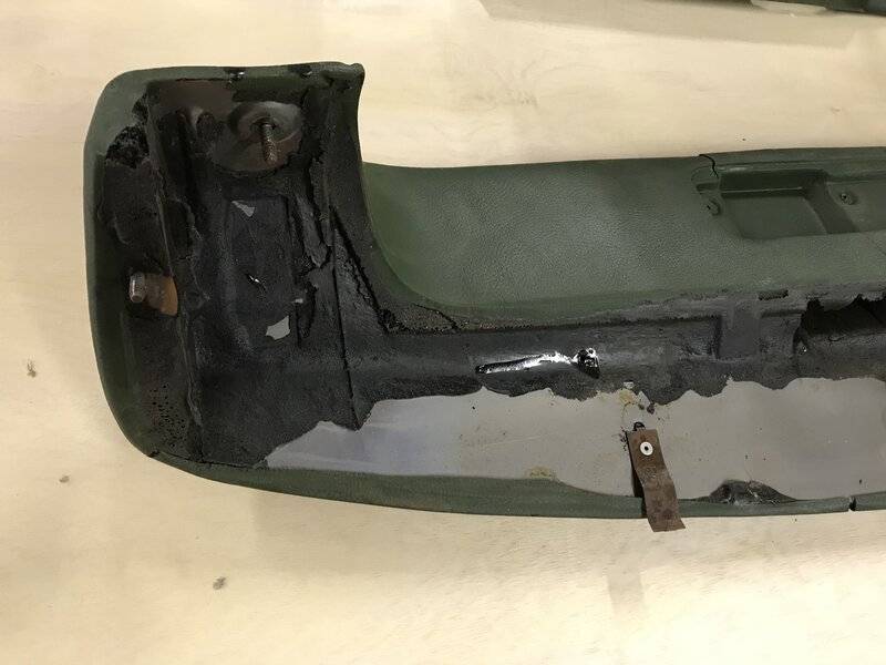

I haven't had to remove it with the dash installed, so I can't say for sure. Its bolted in with some little nuts. You will want to remove the speaker grill and probably the ac ducting if its in place. The hardest ones would be up behind the gauge cluster and glove box. If someone has a pad out and can take a picture that would help show where the studs are. Overall, I would say not impossible, but you are going to owe the swear jar a nice dinner.

I used a dash cap. I got mine to fit well. I had the dash out of the car. A heat gun on low heat can be used around the woodgrain insert in the dash cap to mold the insert into the opening. I might give the vinyl a try on my next one.

Maybe this helps
Perfect.
Texas, that will give you an idea what you need to remove it. Each of those studs with the little acorn looking nut are what you are aiming for. Looks like you can get to all the nuts without removing the cluster, but the speaker grill, ac and glove box probably need to come out. 1/4" ratchet with some extensions will get you there. Throw a little magnet in the socket will help keep the nuts from escaping.
