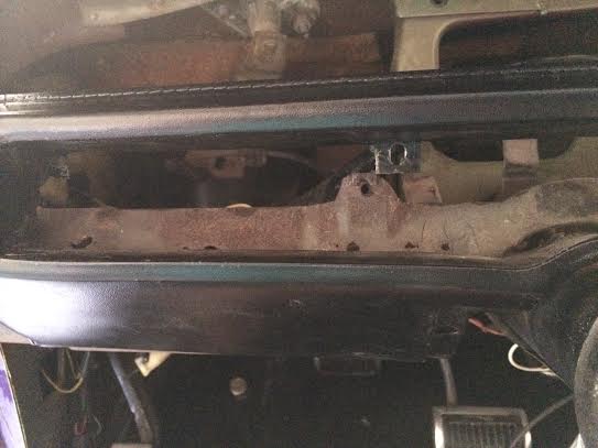

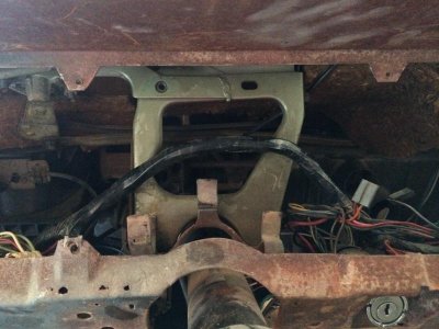

I am building a 69 coronet, starting to mock up the dash to see what I need.

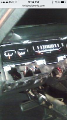

I have 2 styles of dashes sweeper style, rally style.
all the wiring that's in the car is for the sweeper style.
I am not sure how it sits in the frame, I have tried and don't wanna force anything.

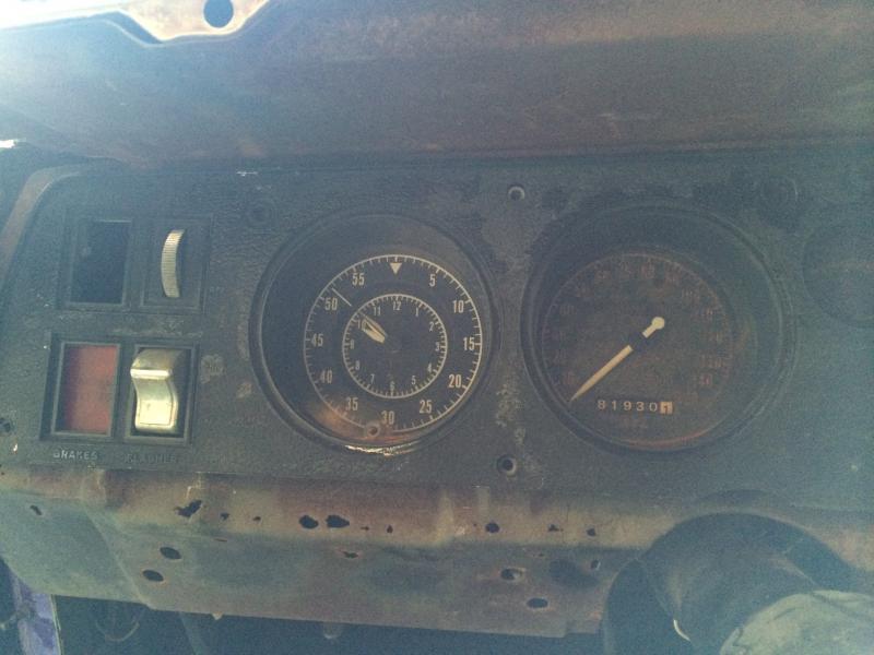

the rally dash fits fine but wiring does not work.
ill grab more pics as I go
some more pics. its a WL21 coronet (low price) vin fender tag and body numbers all match.

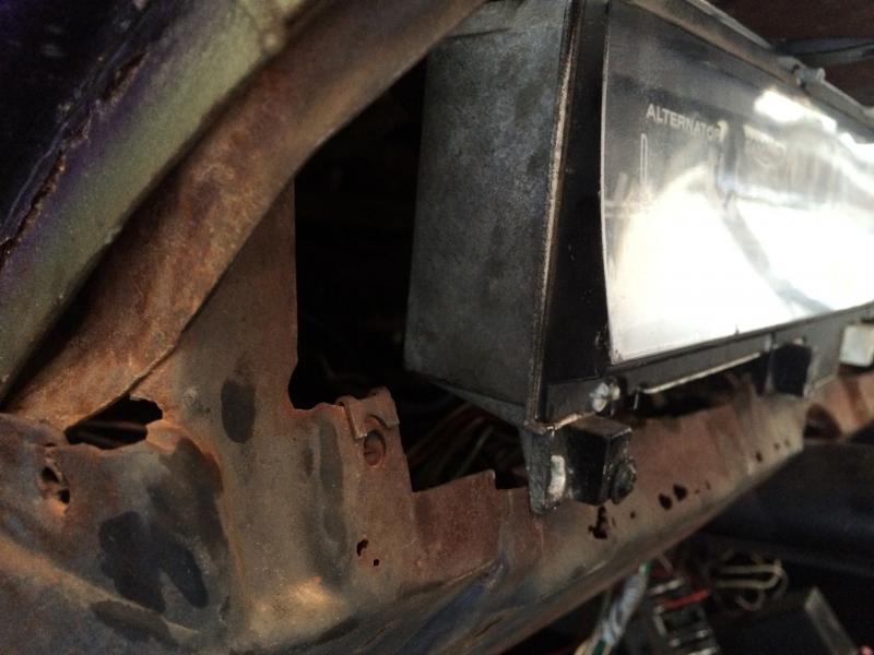

sweeper sitting

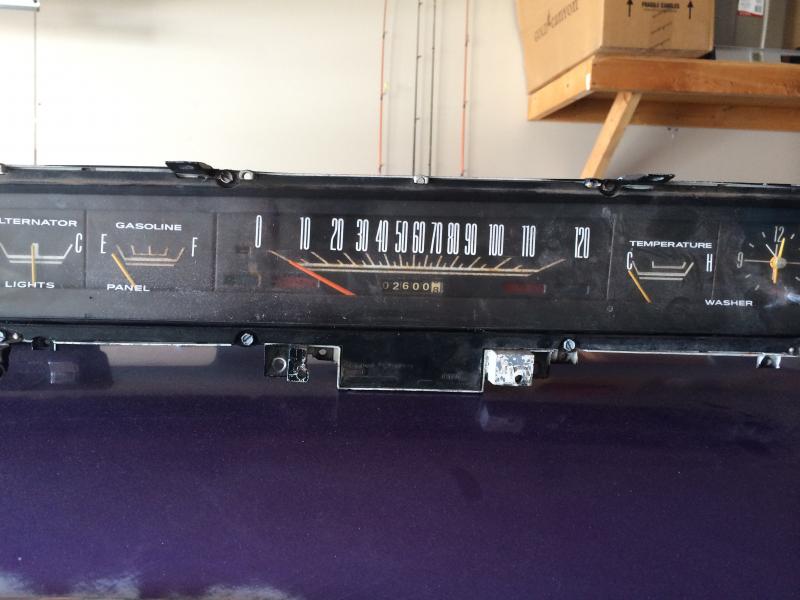

rally sitting all nice
lower dash pad

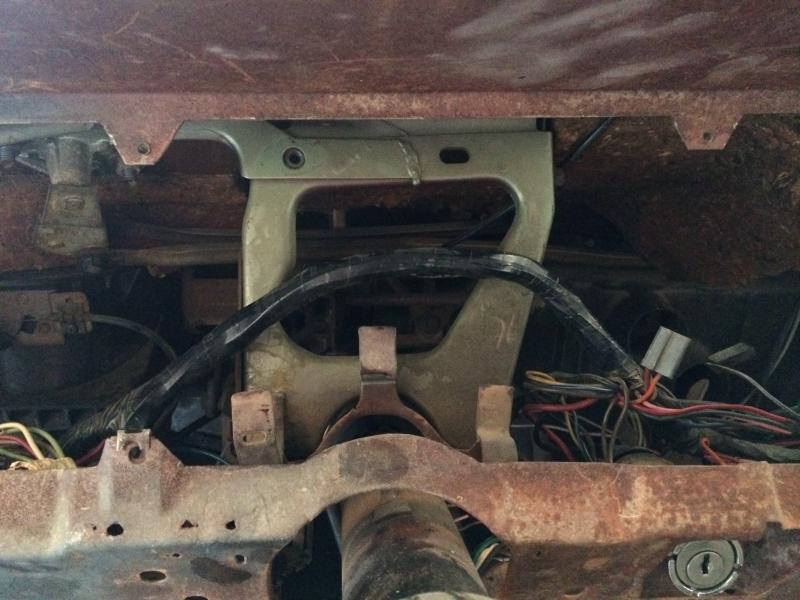

but if you look at next pic I think I am totally lost!
my dash frame does not look the same.
HELP
By the looks of it, it's a rallye dash frame, so you'll have to use the rallye cluster and change out the wiring to use it. Or find the standard cluster frame. The switches for the standard cluster mount in the dash frame, and the rallye switch mount to the cluster. The clusters also have different lower pads. Your lower pad is for the standard cluster, the rallye doesn't have the big hole in it for the switch. The standard dash frame should be easy to find, and I believe is factory correct for your Coronet. Hope this helps.
