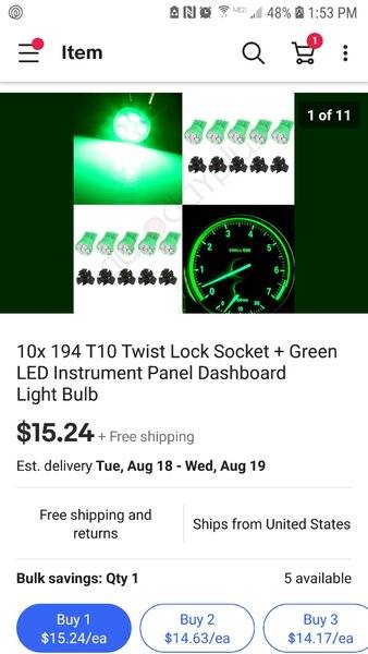

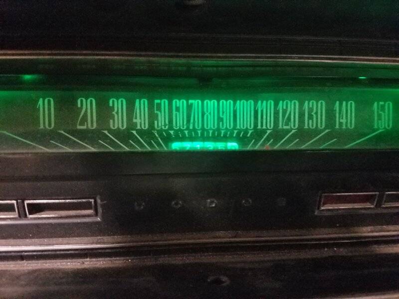

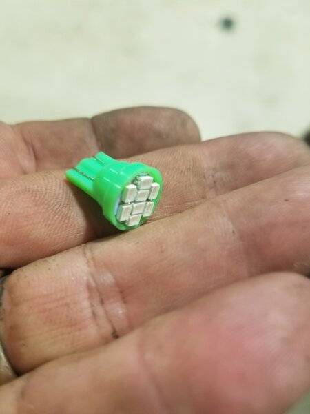

I bought these on Ebay, what a difference! Other colors available too.
LEDs draw a fraction of what an incandescent does, unless you are having a major draw and lack charging, I doubt you would see a difference. Your circuit board would benefit with from the leds.
