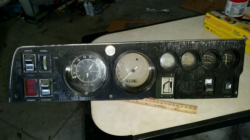

Anyone had any quotes on total dash restoration? or just the instrument clusters? Trying to figure out where to start& what i can do myself,also has anyone made a stand to hold the dash up to work on? the one they have o graveyard cars looks pretty cool but I havent seen any pics of it or if anyone sells them & Mark dont answer questions anymore

Take some pics of the rest of the parts you have that will be helpful, in my experience doing a non wood grain dash to show quality will take about 15 hours and cost around $2500 depending on how much you do and if you start with decent parts or not.. If you have to replace everything but the frame its going to cost a lot...
What color is your dash? take some more pics for us...
