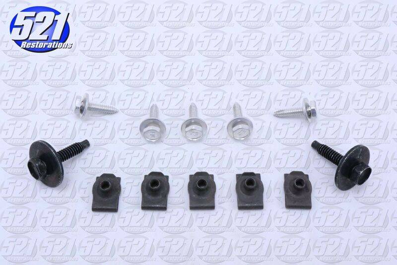

Just Wondering The Size Of The Screws That Hold The Dash Assembley In Place Just Below The Windshield?
I believe the head is 5/16 they look like the 3 silver ones in this pictures center top row. Which now that I look at it all 5 are the same in the top row. And you use the slip on nuts on the cowl.
Here is a link to the kit.
https://www.ebay.com/itm/122134294482?hash=item1c6fc56fd2:g:pgkAAOSwPCVX2fao
10-24 machine screws.
3/8" hex head
Best i remember approx 7/8" length
I can be wrong on the head size its been a while and gtx6970 may be correct on the size. Don't really remember.
