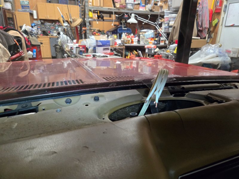

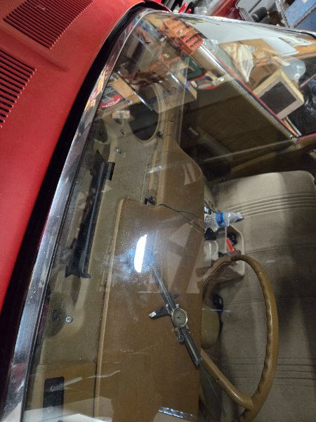

Is it possible to replace the dash speaker without removing the entire dash? I have the instrument cluster out but can't see a way in from where I am.
A/C car damn near impossible.
Non A/C car doable. Remove the glove box and ashtray assembly.
Well that falls right in line with the rest of my issues. Lol. It does need a dash pad...I guess those will be next years project list.

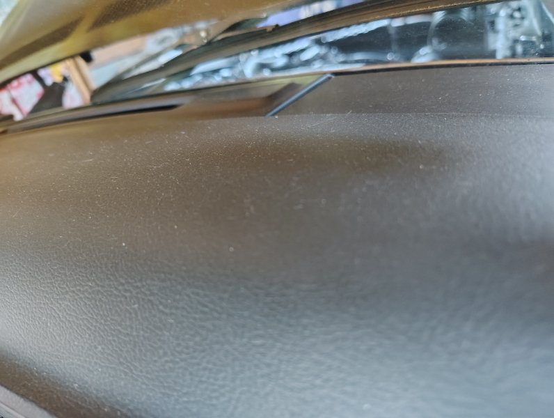

I removed the 3 screws in speaker screen on top of the dash. The plate itself doesn't lift? Are there more screws?
Here a couple bad pictures....

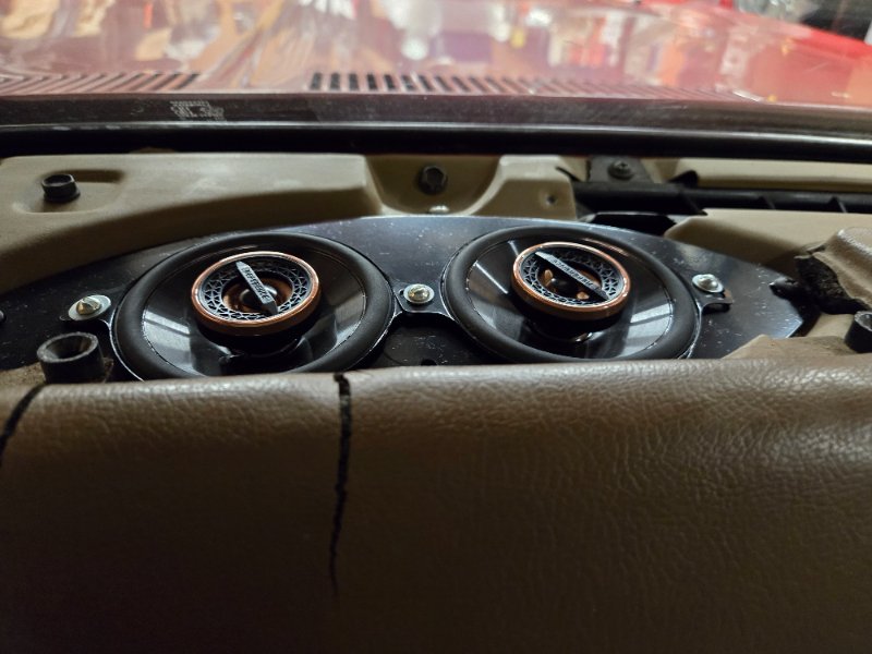

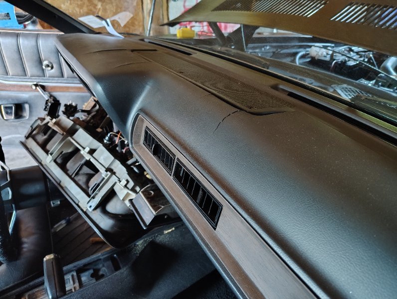

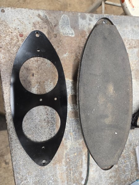

I realize a 72 Charger is only a cousin to a 72 Coronet, but they might be similar for speaker mounting. My speaker grill came off from the inside, and the speaker mounted from the top. I replaced that speaker with a metal template cut out for 3.5" speakers. I installed a couple of Infinity drivers, powered by a modern stereo.
If you're using the original radio you have to match the replacement speaker's impedence to your unit. If using a modern radio you can upgrade to the modern speakers. It was a bit of monkey business to get it all squared away but in the end it was well worth it - the sound is fantastic. Mine is a non-A/C car but going in through the top would not have been an issue if it was.
Grill popped off.
The template, along with the old speaker.
The finished product.
Wow!! That's a wild build! I am still waiting on a ujoints for my 1/4in drive ratchet so I can get to the bolts on both sides. 3/8s stuff I had I couldn't maneuver with my big hands and windshield. I found a modern retro style with modern speakers I'm going to try. Project has turned into everything at once rather than one thing at a time it seems. Thank you for the pics and suggestions!
