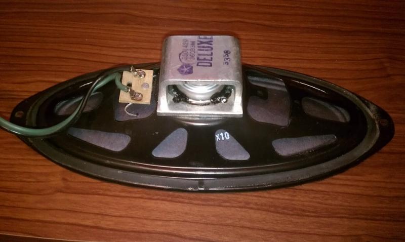

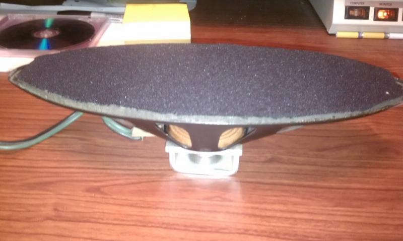

If you want to stay original, and have your original speaker, you can have it reconed. I sent mine to The Speaker Exchange and they re worked it for $80 bucks. They did a real nice job, replaced the coil, cone, and the dust cover on it, kept original plug on it.
Here is what it looks like.
I wish I had the original. I found two old 4" Pioneer speakers just kind of sitting in the hole. I threw them out.

I found a speaker similar to the one in the picture you posted (not the exact same one) plugged it into the connector and it works. Sounds crappy though, but Ive been spoiled by modern equipment
