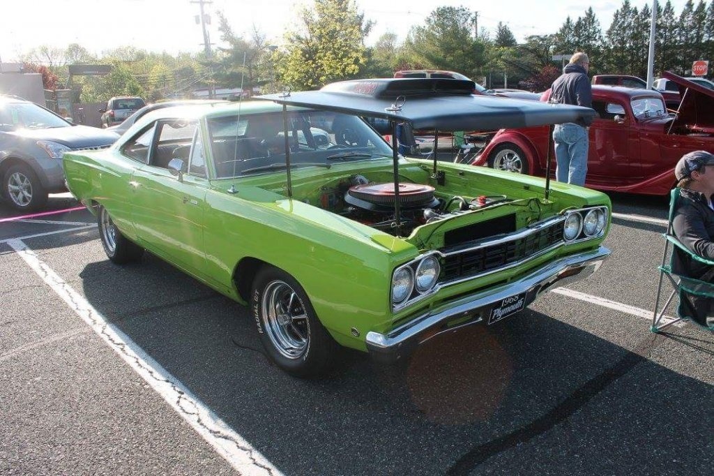

I have a 68 Roadrunner and am interested in replacing the center dash speaker. When I look through the windshield, it does not appear that there is any sort of speaker cover that can be removed. When I look through the radio bezel with the radio removed, it appears that the speaker is screwed in from the top (!). Does this mean that the entire dash has to come out to replace the front speaker? I am going for the A12 street/strip look and have fabricated a radio delete bezel and plan on using an ipod or phone with a small amp and 3.5 mm to RCA connection to my phone run under the carpet and up between the back of the split bench.

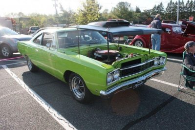

Pic of the car attached. 493 stroker 6 barrel, 4 speed. "Best of - 68 true RR, 69-1/2 A12 reproduction hood, 70 Limelight and birds.
