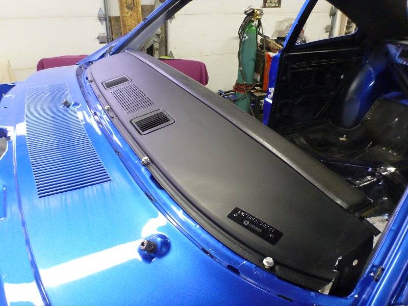

Can anyone tell me what the correct hardware is to install the dash in a '69 b-body. Photos would be appreciated also. Mine were rotted away when I took it apart.

Maybe check with R/T Specialties, he may have an exact kit with the proper hardware for your case.
Hey Wayne, thanks for the pics. Were those in a "kit" or did you just use off-the-shelf stuff. What do you figure those bolts are, 1/4" ?? I can probably get those and the clips at my local Partsource.
****, I just got an order from him last week, I'm not gonna pay another $20 shipping for $10 worth of hardware !!
LOL, they're just 10-24 captive washer bolts and J nuts. They get covered by the windshield seal anyhow... Partsource....
Yeah, 10-24 ... I just dug through my bolt box and found 5 1/4" but they don't fit the middle hole in the dash. Gonna have to try NAPA ... Partsource only had 1/4" u-nuts
