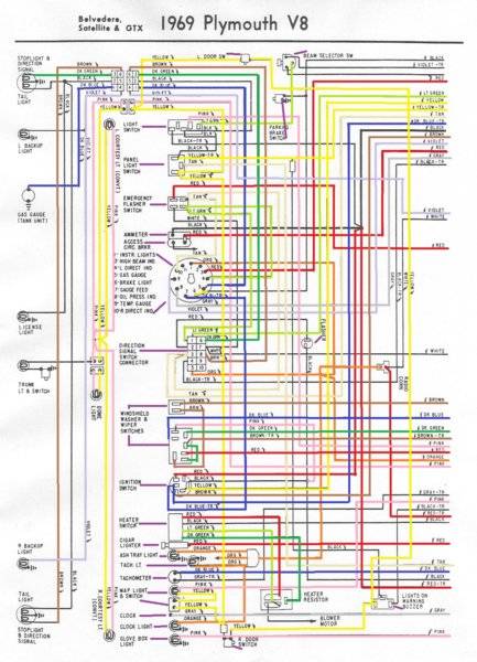

I'm trying to install the dash harness on my 69 GTX, and looking for some good detailed info. The new harness doesn't have circuit #s or any kind of id tags. Some are really obvious but others not so much. Also I'd like to get the correct routing. If anyone can point me in the right direction I'd be forever grateful!

Are you installing a repop of the original? If so start by downloading the FSM for your car. You can download the Shop manuals and wiring schematics from the following links. But generally its a pretty simple harness to install. I don't think there are 2 alike connectors in the entire harness. So they can only plug into one thing. But aside from the links below I do believe someone here posted an entire HOW TO of all the connections. I can't remember who that was. I'm sure someone will chime in.

Mostly routing and all the single connectors. I think I found some help from 68 Cornet thread.
Well Here is a colorized wiring schematic I did. The purple lines indicate what switch/plug/light the plug goes to. There are a pair of wires pink and white single plugs under there that go to the brake light switch on the brake pedal assembly.

PM me your email address. I am not a gold member so I cant send pictures in a PM. I will do the other page in color too..
Here is the back half of the car. Keep in mind there are some wires that are marked with tracers and with the limitations of my paint program I can't do black with a tan tracer.. You will have to look at the wire color and check that. But for the most part It should help make sense of where the wires start,end and their function..
