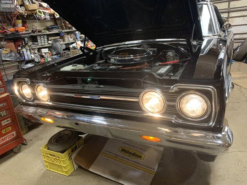

Good morning. I purchased all new wiring kits from Year One. The quality is definitely there with the M&H stuff. I don't however have a '67 Service manual showing an under dash wiring diagram. The internet has failed me in a search for a clear image of the diagram. Can someone post a pic? It would be most helpful. There are a couple wires that could go a couple of places that have me a little more confused than usual. The car is a '67 GTX.
Thanks. The parking lights come on when I hook up the battery and the wipers don’t park so I know I got sumpin wrong.
The wiper harness is a seperate harness from the bulk head connector.. The parking lights could be an issue with the switch or possibly the turn signal cam and harness.

Good call. I wasn’t going to buy something but it’s probably the best option. I’ve got the gremlins worked out now but it’s still good to have
