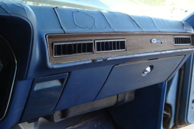

The right hand vent outlet section of my dash has cracked . Does anyone know what this section is called and if so where can i get another one?
Dane
i don`t think anyone is reproducing them, best place to find them is on here, moparts.com or swap meets...
There is a place in California that redo them,Called Just Dashes,a little expensive,but they do a relly nice job.

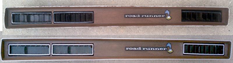

I had a similar problem where one of the vents was missing the center director, so i found another used on that was dirty but had all the directors, and the housing was not bowed, so i pulled all the old ones out, cleaned and repainted the trim and reinstalled.
Here is the before and after.

How did you get the vents out? I need to replace a broken one on mine,but I don't see how to take them out without breaking them. Thanks, Marty.
I have a link to the dash pad/cap thats cracked if you want it, the vents looks covered, moparmarks has a few.. hope the site changes didn't scare anyone off lol.
There are little pins that have to be pushed out fron the inside of the vent. The vent swivels on these pins.
