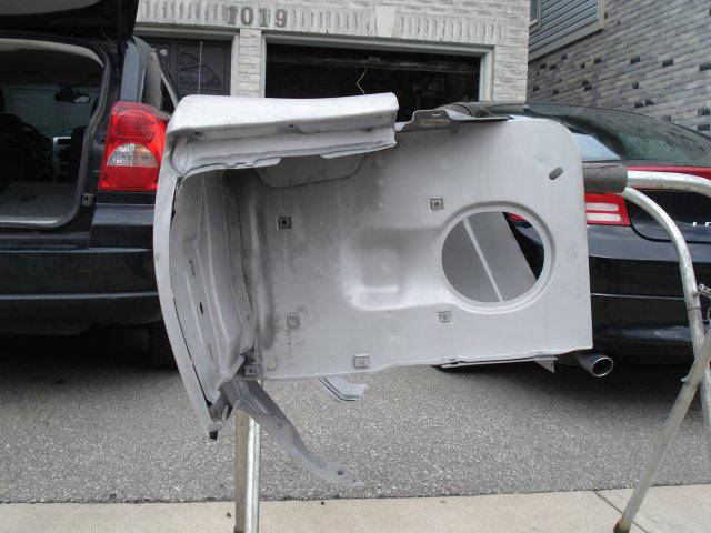

The question I have is can someone send a pic of what the inside of the fender is supposed to look like, the brace looks like it was cut off and has 1/4 bar stock welded in place as the interior support. I'll post pics tonight when I get home. I need to know what I need to do and where to get front fenders if I need to replace them.

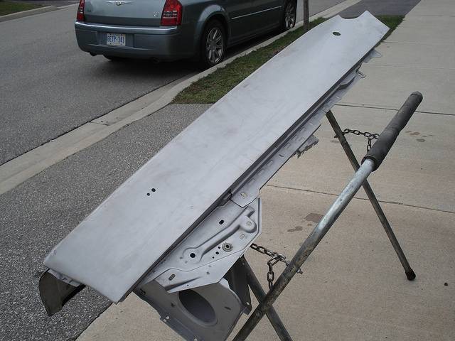

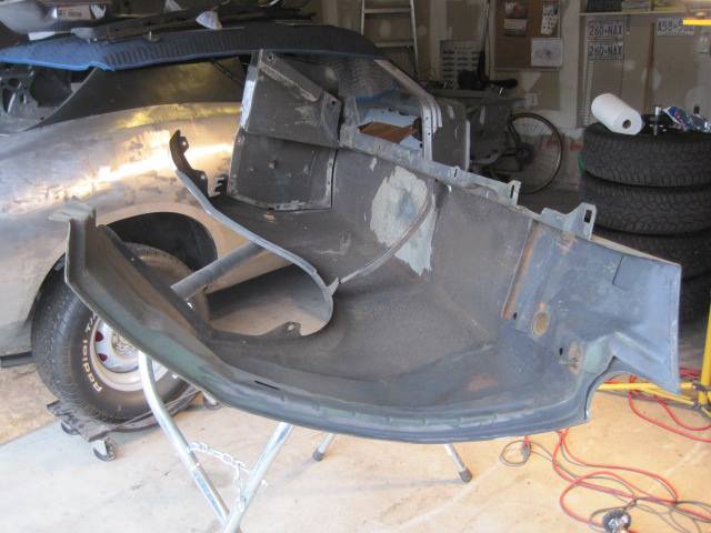

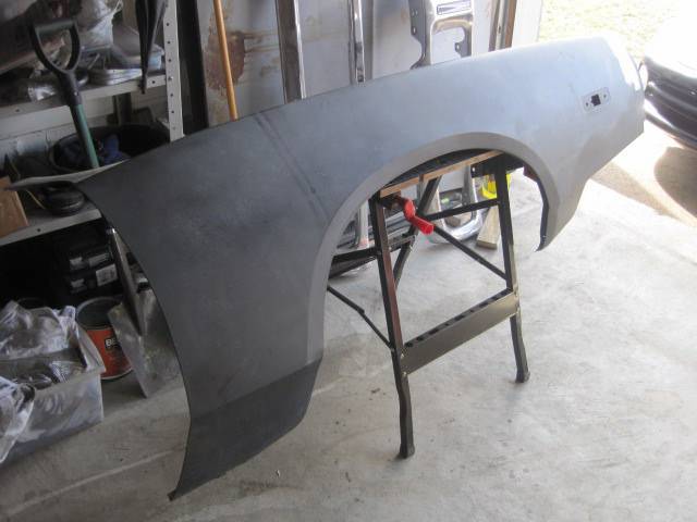

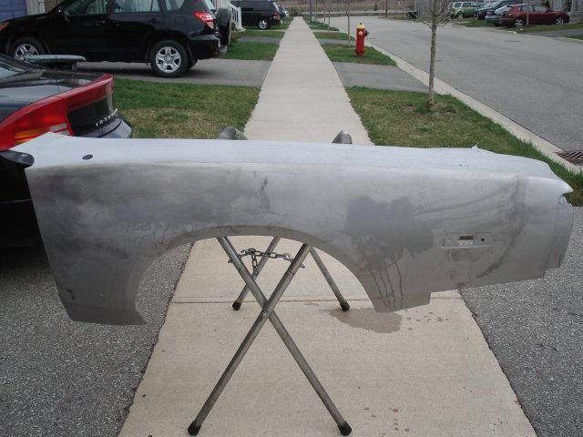

You still need a fender picture ? I can go out when the light comes back and take a picture ! I have 72 parts but it's the same minus the light

Probably not a lot of 71 Charger donors growing in Hawaii. I can get a pic today.
YEs the pics would be helpful.

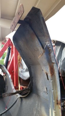

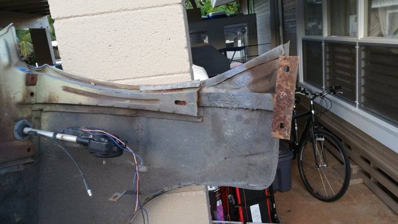

Crap I hope the new lowers have the lower support. Your support runs all the way from top to bottom.

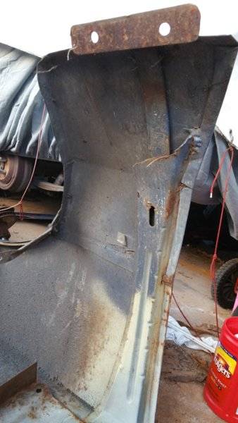

This is mine....
What to do.
