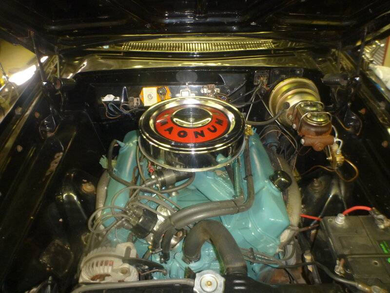

I am looking for an air cleaner setup for my 440 Daytona, was wondering if all 68/69 non snorkeled setup would fit the Dodge ? Like a 68RR 383 4 barrel? would that work?

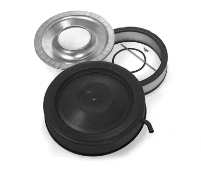

Grabbed this from Nicks garage air cleaner page.
1968-69 340, 383 and 440 4-Barrel unsilenced except early 1968 models. Mopar Performance reproduced these in black wrinkle (P4529001) and chrome (P4529002 or P4529025) but factory units were always black wrinkle.
1969 383 and 440 4-Barrel with Air Grabber or Ramcharger fresh-air hood. 383 baseplates are different and sit higher on the carb than the others. Click here to see how to tell them apart.
