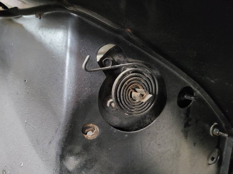

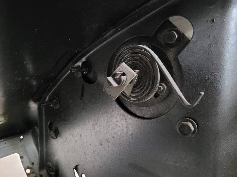

Do the Daytona headlight have a spring to open the head light buckets if you lose vacuum? If there is no vacuum how do they stay open?
Yes, the spring pops the doors up.
It’s a safety feature.
Does anyone know where to get those springs or what they look like?
Thanks, any idea where I might get the spring? Or what it was from? or used on? I can always make that spring clip. Thanks again
Boy those look like the springs on the window regulators. i will look at the sets I have
They were unique to the Daytona and Bird, IIRC.
