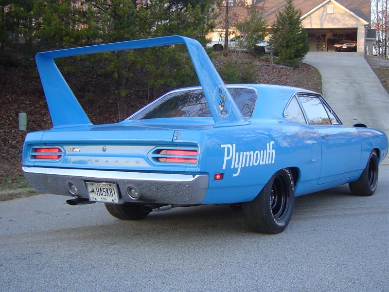

Very nice one !!
I like the wing cars original or Not ! I love them all !! :notworthy:
I have a clone myself, started with a satellite. I wish I would have put the rear window plug in, but I am not going to tear it apart just to do it...maybe one day. I like the look of yours, nice car.
Nice Bird JON!
