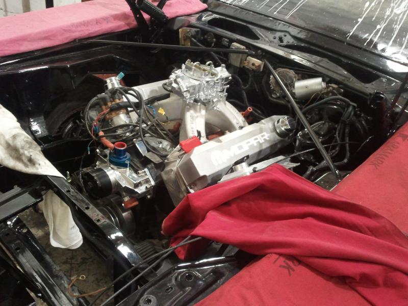

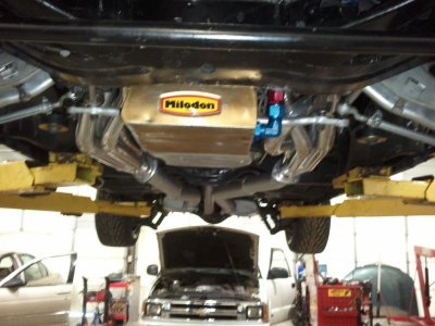

I am nearing the end of project on my 1973 Charger and my wallet as well. I bought a replacement 440 race engine to install in my new project. While it is as advertised as the beast it is, it is not a particularly street friendly. I must admit it was not particularly the smartest move on my part and unfortunately speaks to my inexperience. Admittedly, my pride got the best of me in approaching this project in that I was trying to shut-up my "Chevy-loving-in-laws", which this engine will certainly do, but I would like for the engine to be more street-able. I will tell you all I know about engine and my purpose. My purpose for this car is to have good power, but used 95% on the street, and to de-tune this engine as inexpensively as possible. Known specs are as follows; Displacement- 440 honed and sq-blocked bored .30 over, crank balance 10/10, Ohio beam rods, Weisco flat top pistons, Mopar Performance aluminum heads milled .60 thousands and intake port matched to Victor single-plane intake manifold, Mopar performance valves and springs, compression is 10.9 to 1, MP purple shaft cam has .590 lift w/ 312 duration, Proform 750 racing DP carb, Felpro head gasket, Clevite bearings, Menzeire electric water pump, Summit SFI oiling system. Summit 1 7/8 ceramic headers w/ 3" exhaust. This a $10k engine with the millwork that I bought for less than half of that. My question is; can I get by with just a cam swap, if so, what would you suggest? Do I also have to go to a dual plane intake? Do I have to reduce the compression?

Wished I had you guys closer to me to get this thing dialed in. Everyone around here, doesn't know how to work on anything but a chevy. I think the biggest mistake was buying too small of a stall (2400-2800), and put a thermostat in the electric water pump. I have a 4 core radiator with large electric fan w/ shroud, which should cool. I guess the thermostat is restricting the flow too much. Easy fix to take out the thermostat. I'm open to all suggestions, in just a little over my head and don't know where to go from here.
Sounds like the real issue here is the poor cooling, not the street manners of your motor. First off, what temp is it running at currently? A lot of guys have this idea that 160 is proper running temp when in reality it's 180-190 or even a bit more. Are you sure the cooling passages are free of scale in the block?
There is some debate on this issue, but IMO, t-stats should not be removed as they are placed 'after' the pump and block for a reason. The pump is fighting to move coolant throught the system but the stat sets up a restriction. This forces the coolant into every passage and especially the really hot spots where without lots of coolant replenishment, there might be localized boiling. all this increases thermal contact between coolant and motor = better cooling. A better question is Are you sure the stat is even opening?
What cfm water pump are you running? is it getting proper current / voltage to maintain proper cfm? IMO, running a higher cfm water pump is also a great idea. Cooling efficiency depends on 'delta Temperature' - the diff between the temp of the hot iron and the cool coolant. The more flow, the cooler the coolant remains, so the faster and more effectively the heat flows from the iron to the coolant. also, the faster the coolant flows, the more turbulent it flows through the radiator, so the more coolant is in contact with the rad tubes, thus the more effective the rad is at extracting that heat.
That's about the extent of my suggestions, but maybe your timing is off? I understand it can affect engine temps quite a bit but that's out of my area.
I just looked at those water pumps - they're beasts... and EXPENSIVE. Says it should be plenty to cool 650 hp at 35 gpm. The bigger one flows 55 gpm (and an intermediate flows 42). As long as it's set up properly, the pump shouldnt be your problem.
Probably not the case here, but they do sell one for 16V applications but say it will work for limited 12V situations. Sure that isnt the one you're running?
What make / cfm fan(s) are you running?
Just finish it and drive it. That's not an uber radical race piece, it's just a nice, warmed up combination. It'll do fine on the street. The only thing I'd change, is to ditch the electric pump. Those usually can't move enough water to keep a car cool on the street. You've got plenty of HP on tap, so a few to drive a good water pump won't be missed. I can't tell what distributor that is,or if it has a vacuum advance, but I'd run a good ignition and I'd keep some timing in it down low. I run mine locked out at 34 degrees on the street with no vacuum advance. Low initial timing builds heat.
