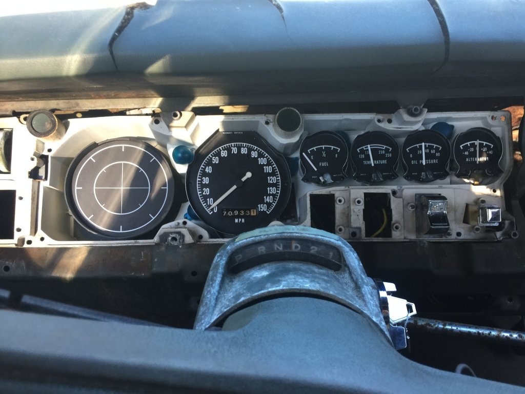

As I am waking up my 70 RR from a 30 year nap, I have no readings at all on fuel, temp or oil pressure. The voltage gauge works just fine.
Per suggestions in my build thread I did the change out on the Voltage regulator behind the dash. Swapped in a 7805 silicon chip and wired it in. Plugged everything back up and still nothing.
On the power input wire I have 12 volts coming in. With the chip wired in I have 5.4 volts on each positive side of each terminal when the key is turned. The oil gauge sending wire is modulating when I measure impedance leading me to believe the sensor is sending the signal, ohm range rises as the throttle is pressed.
When I pull it all out and test it on a battery on the bench I have the same readings as in dash, I am running power to the input prong and allowing the 7805 to kick down the voltage and getting 5.5 volts on positive side of each terminal. If I touch the input side of each gauge with a ground I get a quick movement of each hand. This is not happening with the Fuel gauge which I swore was moving prior to starting this.

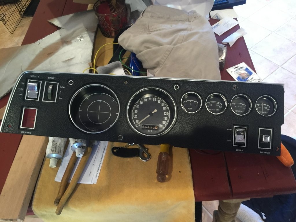

Problem solved, Gauges bad, new ones arrived and nothing else done and they work properly(except gas it is not hooked up at the tank).
