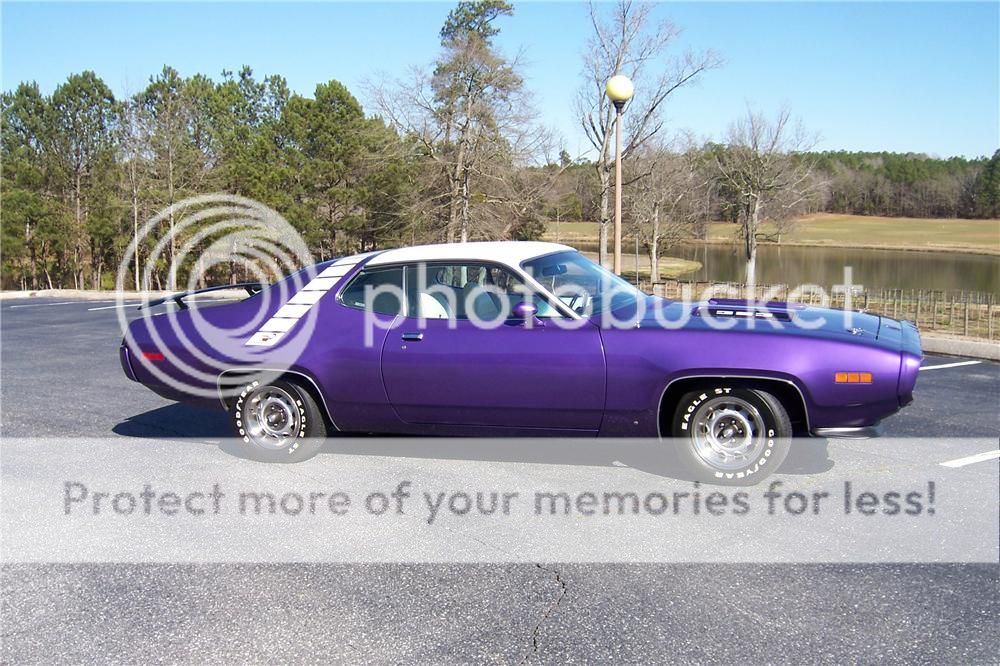

the roadrunner is getting closer to paint and decals ,body man wants to clear over the decals
apparently "all" show cars have clear over their decals . after opinions from those in the know
so to clear over decals or not ?
this is what she will end up looking like ( decoded from fender tag , 340 not 383 )

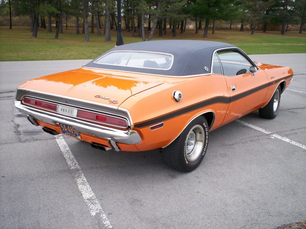

I have some friends who build "High End" cars, and they paint the stripes, THEN clear over them. The outcome is the Best I've seen...I don't think putting the clear over a vinyl product is a good idea. It will eventually chip, or flake off the stripe, and you'll end up replacing the stripe, or worse, if it peels the clear off the color. My R/T just has the vinyl over the color, and it's held up very well...

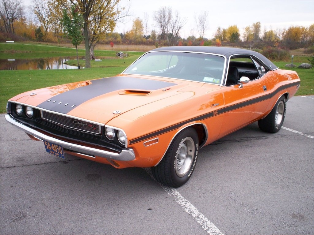

That's how my Hood and tail panel are done, can wax or polish and always stays the same semi flat.
Definitely nothing over the side stripes.
