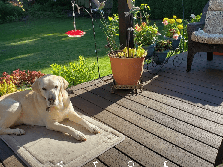

First generation Trex was a ******* disaster. Got about 10 years out of it, but was a chore to keep it clean. Replaced it about 8 years ago with a Lowes brand. Allot better. Make sure the coating goes all around the sides and groves or moss will build up. Also the dark brown boards we went with are very hot and impossible to walk barefoot in the sun and also could harm pets. The product does shrink so all butt joints should be tight. The retail store are not going to carry the same color from year to year.
