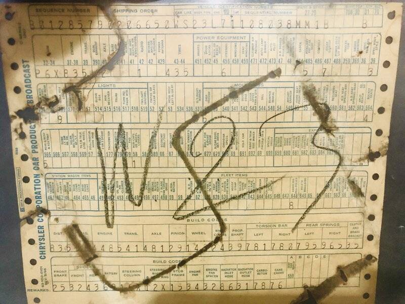

Can anyone help me with this and decode my 67? Trying to get as much info as I can on the car I recently purchased. Unfortunately am missing the fender tag - but car came with the Original Build Sheet. Thanks in advance!

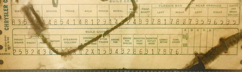

I think we're going to need more of the sheet.
440 HP engine, non CAP, single point distributor, 4237 carburetor, 727 automatic trans, 2.94 8.75 rear axle. 11” manual drum brakes, 7 blade sold fan, 26” radiator 2785936 std cooling, black interior, black 3 spoke steering wheel, partial horn ring. 14x5.5” black steel wheels.
Can tell you more with the rest of the sheet.
Thanks guys! Here is the full sheet: sorry I know the quality isn’t the best but it’s all I got!
Code M turbine bronze body and roof
Black pinstripe
Black bucket seat interior
Column shift
Center buddy seat
2.94 open rear axle
Full wheel covers
2 speed wipers
AM radio
Power steering
7.75x14 Whitewall tires
HD suspension wirth sway bar
Rear arm rest ash trays
Cig lighter
no undercoating or hood pad from the factory
Black pinstripe
Column shift
Center buddy seat
2.94 open rear axle
Full wheel covers
2 speed wipers
AM radio
Power steering
Cig lighter
