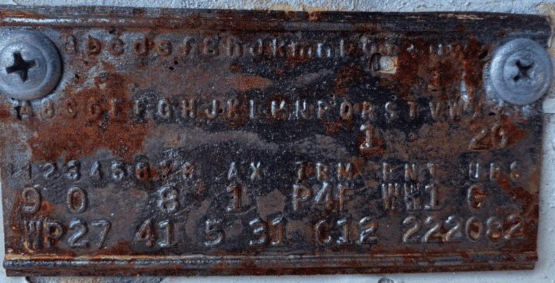

Does anyone have access to a decoder? I can't seem to find one for my 68 Coronet.
Any help is appreciated.

1968 Coronet 500 convert
318 auto 2.94 open rear
AM radio
Ordered car
Green top
White paint
Green pinstripe
Scheduled production date C12 December 12 1967
P4F and no codes under “a” so this is bench seat.
Very low options, the codes under 1-8 are usually trim which a Coronet 500 convert has lots of as standard.
wheel well
Rocker
Belt line
bench on a 500 is kinda rare but I've seen it on convertibles

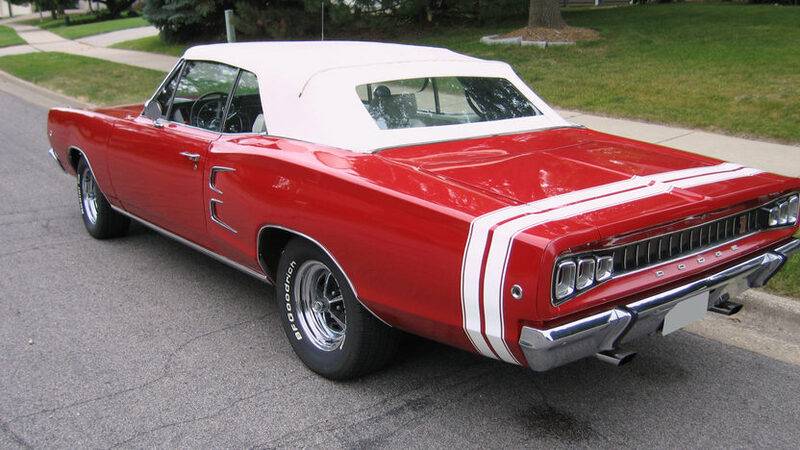

very interesting. On the green pinstripe, any idea where that was on that year? Is it across the tail like this?
Nope.
"Standard" pinstripe about a inch below the tops of the fenders, etc.

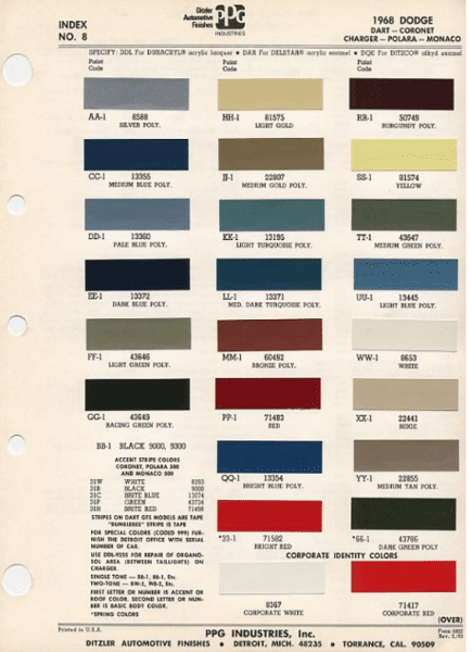

The stock color wasn't a bright white... Back in the day lotta cars got repainted "Corvette White" cause it was a bright white.... Look how much brighter the "Corporate White' is than the WW-1 code white..

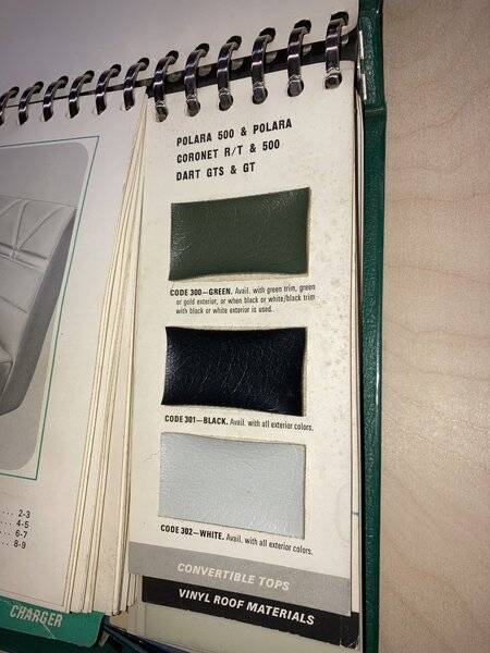

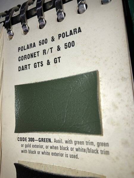

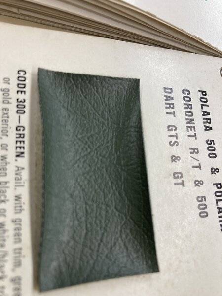

Any idea what the original green convert top print is? I have this car but currently has a black top that needs to be replaced and would like the correct top but can’t find a definitive answer on it
0 under the Y means green convertible top.... Didn't have any luck finding a picture...
