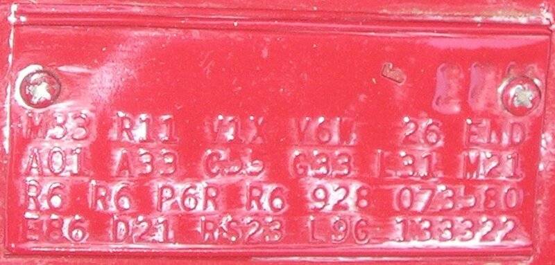

Please decode this 69 gtx I'm about to buy
RS23:
Plymouth Belvedere,Satellite
Special, GTX
2 Door Hardtop
L96: 440 375HP 1-4BBL 8 CYL
1969
Newark, DE, USA
133322: Sequence number
E86: 440 cid 4 barrel V8 (High Performance) 375hp
D21: 4 Speed Manual Transmission
R6: Red (Dodge), Scorch Red (Plymouth), Crimson (Chrysler) Exterior Color
R6: Trim - Unknown, Vinyl Bucket Seats, Unknown Color
P6R: Unknown Int. Door Frames
R6: Build Date: 6
928: Order number
A01: Light Package
A33: Track Pak w/3.54 ratio
C55: Bucket Seats
G33: LH Remote Racing Mirror
L31: Hood/Fender Mounted Turn Signals
M21: Roof drip rail moldings
M33: Body Side Moldings
R11: Radio Solid State AM (2 Watts)
V1X: Full Vinyl Top, Black
V6V: Longitudinal Stripes, Orange
26: 26in Radiator
END: End of Sales Codes

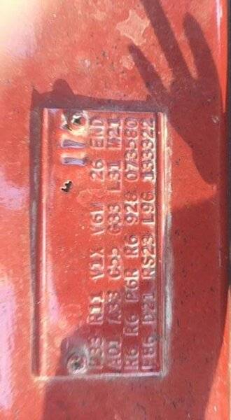

QOTHL IS 99% right. It's L9G, meaning 440, 69, St Louis built.
P6R indicates red premium bucket seats. Third R6 is the upper inside door frames.(red). And it looks like V6W to me, would be a white longitudinal stripe.
928 is the scheduled build date, Sept 28, 1968.
The rest I absolutely agree.

I had a hard time reading that photo. Thanks.
Track Pak car
Wow red with white stripes don't think I've seen white stripes before on a gtx..seems weird figure they were black

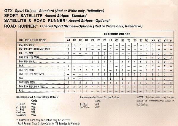

Think it says V6W NOT V6V
Agree. V6 is a longitudinal stripe (at least on a rr, I'm using a very good 69 rr book). The third digit will be the color b-blue, r-red, w-white, x-black, g-green, etc.
Same for interior colors, vinyl roof, too.
So did it have a white stripes down the side at bottom..any hood accents or just plain red
I don't know if a hood accent would be on a st.L. tag.
Performance hood treatment on a rr would be V21 on the fender tag.
I think it has (had) white stripe just above the lower rocker moldings, at the bottom of the doors.
I think you'll find V6* only came in two colors...Red or White.
