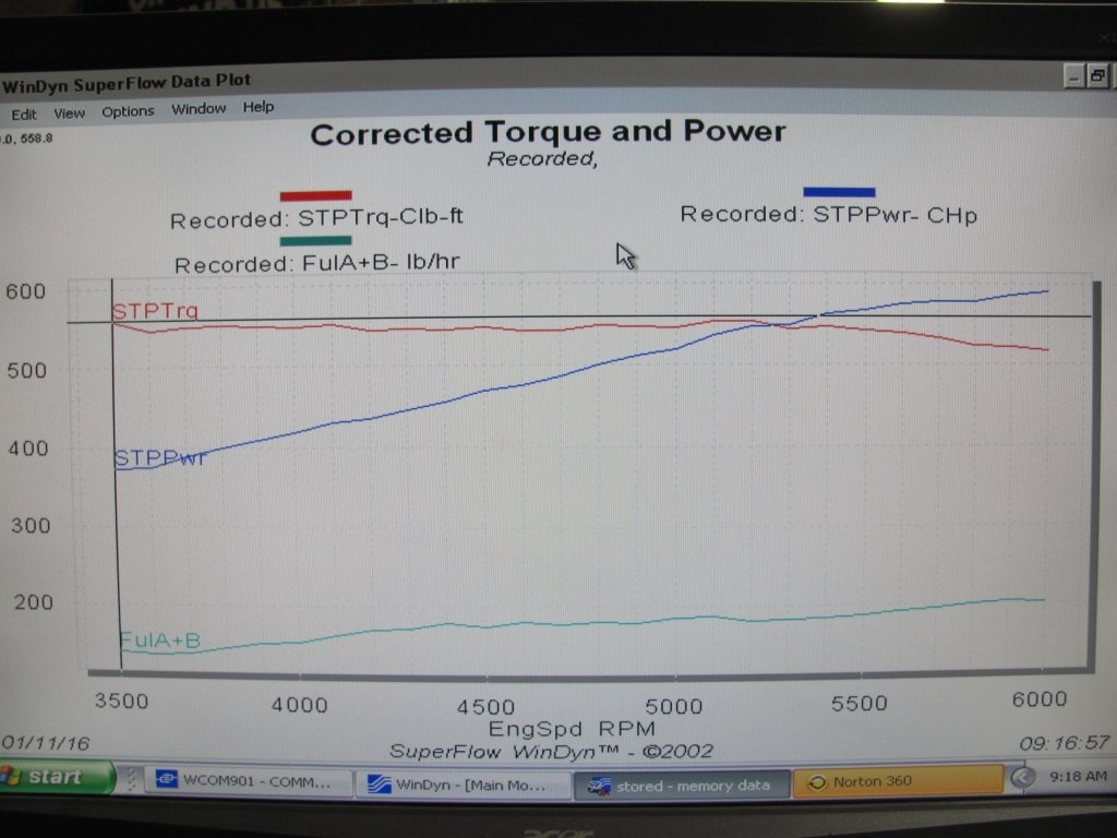

A flat torque curve is possible with the six pack. This is a dyno graph of a stock stroke 440 running a deep port matched six pack intake that we did here at La Roy Engines. The deep port match on a RPM dual plane intake didn't take effect during our 496 stroker dyno tests until about 5,500-6,200 rpm where we started seeing around a 15 HP increase.

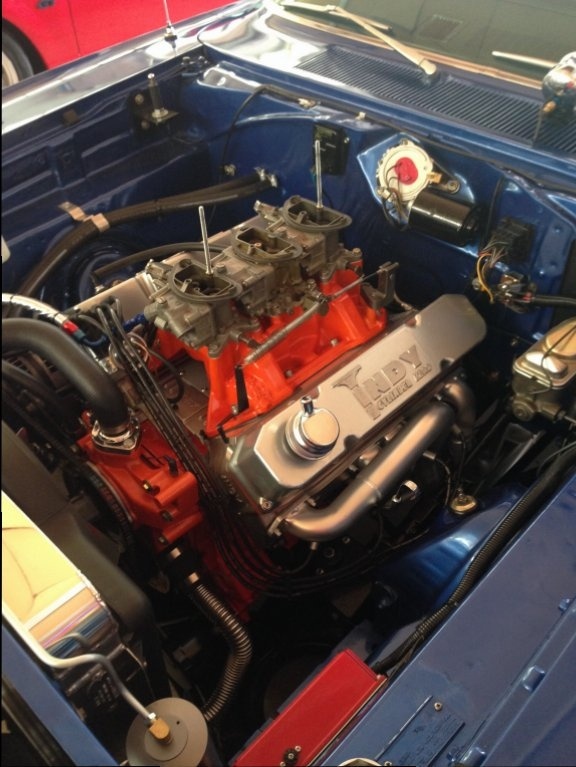

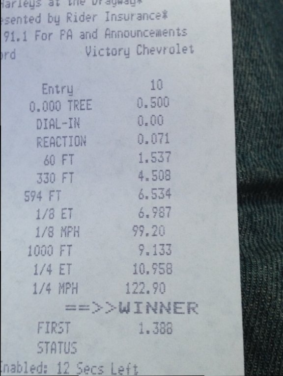

There's only so much your gonna do to a six pack manifold. I gasket matched mine and took it as far in as I could. Smoothed out and radiused any sharp edges under the carb bores. Took me a few hours and a six pack, (of beer). Went 10.95 first time to the track with the mufflers on. Only thing I've noticed on the stroker is the distribution isn't nearly as good as a stock stroke motor. Like said above, it would be daunting or next to impossible to try and even it all out perfectly. It will work though.
