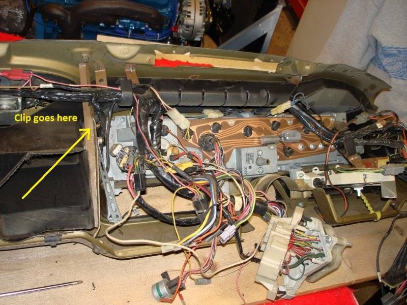

Putting my dash together and I do not know what the tab and wire clip attach to on the duct. The car did not have the defrost duct when I got it,so I might be missing a support from the dash.The manual shows something the wire clip fastens to but it is missing. What amI missing?? Thanks. POPS
there is a 2 piece metal support
one piece goes to the dash frame top and bottom it is nut and bolted on both ends
and the 2nd piece is bolted to the middle of the first support
and it then goes to the duct
the clip you mention goes in a hole in the 2nd support.
your car must be nickle and dime ing you to death!
YEP !!! Missing lot's of small stuff for sure.So now once again the hunt begins!!! (lol) Thanks again for the help. POPS
Thanks for the great picture,all you FBBO members are a great help.Hard to put it together if you did not take it apart!!!
