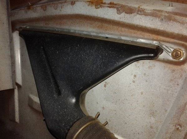

My guess is that you need this for a 2 door '67 Coronet. I have one from a '68 B Body 4 door (pic below) which are wider than the 2 door version.
So be careful if someone is selling you one from a 4 door claiming that it will fit a 2 door version. I see this mistake often on eBay.
Thanks for the info, I did not know that! Kind of odd that they would tool two different pieces...
I think the reason is practical as the rear windshield on a 4 door model has a larger surface area thus needing a wider plenum to get the job done.

Yes. It's possible that 67 may differ from 68. But we are talking about the REAR defrost vent which are different between 2 door and 4 door within the same model year. Front windshield dash defrost vents are the same for 2 door and 4 door within the same model year.
That is my assumption but I may be wrong too. If the OP is looking for front ducts then I believe any 66 or 67 b body will work...including all he listed plus the four doors and wagons. However good luck on finding ones that have mounting tabs intact. They are notorious for breaking.

I'm fairly certain there's no difference at all in rear vent setups from 66 all the way to early 74.
Do you mean no difference between 2 door and 4 door? Or no difference between model years? When referring to the rear vents?

RE rear defrost.
I think all B body is the same.
I pulled one from a 73 Coronet 4D and it was identical (except for the switch) to the one in a friends 69 Charger.

Don't be afraid of broken tabs. If somebody is selling a set and they still have the tabs, albeit broken, they can be repaired.
