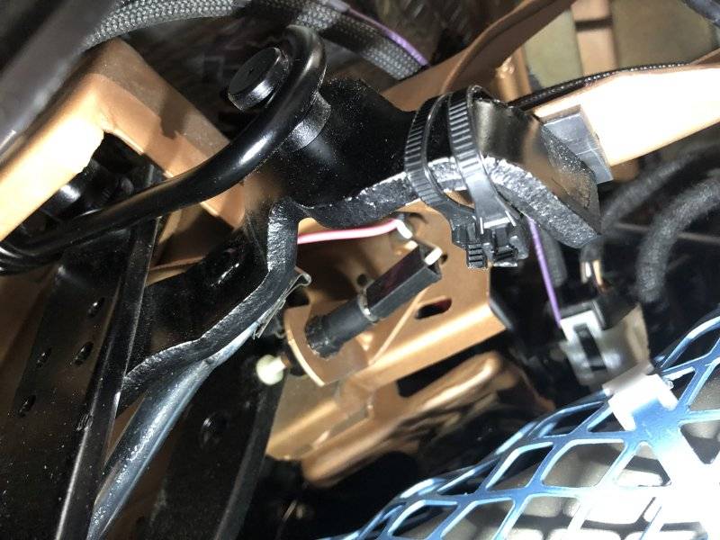

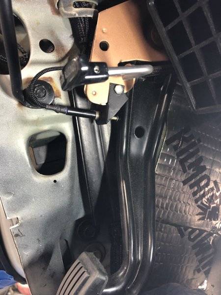

Good morning - I know there is a switch that mounts for the brake lever and a switch that mounts for the parking brake. I checked the '68 Service Manual for Charger/ Coronet/ Dart and could not find an image showing how either mount or the location. It doesn't mean it's not in there but would appreciate an image of similar installations for a 68 Coronet. I appreciate your time and help - Jay

68 Road Runner. My guess is they are identical.
E-Brake switch:
Brake light switch (master cylinder pushrod not installed)
Oh God Bless you! This clarifies a lot for me. I really appreciate your time and your help. Have a pleasant day - Jay
