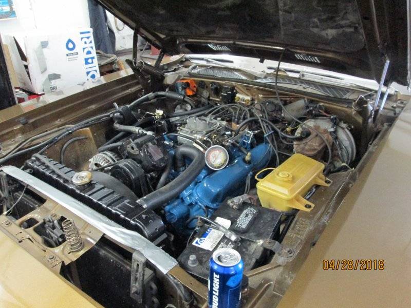

Long-time member, haven't posted in a while. Older enthusiast. Having fuel issues. Question is, fix what I have or slap on a new carb (which I have)?
Car is a '73 Satellite Sebring Plus. Motor is a rebuilt 360, ported heads, 340-spec cam, HP exh manifolds. Engine has about 3-5k on it.
Carb is a Summit 600 vac sec, which I understand is a Holley knock-off. M08600VS. About two years ago, noticed after I accelerate hard (opening the secondaries) and take my foot off the accelerator, the car would surge for about 2-3 seconds. Still does it. Recently, I stopped for fuel, when I shut off the car, the motor dieseled for about 15 seconds. Never did that before. Are the issues related?
About 18 months ago, I bought a rebuilt Edelbrock AVS2, 650cfm w/ electric choke and the tuning kit from National Carburetor. On my previous Mopars, I've always sought out rebuilt Carter AVS carbs to run on the 440s in my '70 Charger and '72 Satellite. Have not put the Edelbrock on the car...yet.
Decision point: car is going to a local classic car dealer for some service next week (unrelated). Should I have them slap on the Edelbrock and tune it or sort out the Summit carb?
Fire away.

All very good questions, R413. a few answers off of the top of my head:
idle vacuum: will have to throw my vacuum gauge on it
idle speed: 500-800rpm
exhaust smell: recently runs rough when cold, low idle, as if the electric choke is not functioning.
Fuel age: recent, less than a month
Sitting: no more than a week at a time during the Spring/Summer/Fall
Recent changes: Long story, but a different shop doofus recently (6 weeks ago) messed with the timing, which pissed me off. I "think" this could be a contributing factor to a few things, or just a coincidence. They said they reset it, but I have my suspicions...dieseling happened after that
Ignition system: electronic
Coil: I forget
How old: the car or me?
The dieseling/run on is a brand new issue and just happened the one time. The surging after WOT has happened continuously for 2-4 years, hence why I bought the Edelbrock carb. The car is a cruiser but I'd like it to run well (duh, who doesn't?) Based on your inputs, I think the timing needs to be reset and the carb swap is a personal choice, of course. Holley vs the world. In my time, my preference is the Carter/Edelbrock AVS, but to each his own.
