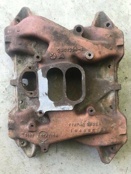

What is the difference between 440 Intakes 2951736 and 2951736-1 and which is correct for 1970
a search showed the first number is correct for 70-71 440.
Casting Numbers - Big Block B/RB (mopar1.us)
Mopar Casting Numbers - MyMopar.com - Mopar Part Numners
I don't see any "dash 1" numbers, so maybe that's a shift or revision or ??? My "guess" is that both are correct, but I'm not sure
above photo shows art number 2951736-1
I already believed you, but dash one isn't listed in parts lists
When they reset the casting molds, they up the revision. So lets say they cast 500 manifolds then they make an adjustment. That becomes -1 and so on. I have seen block revisions up to -10
