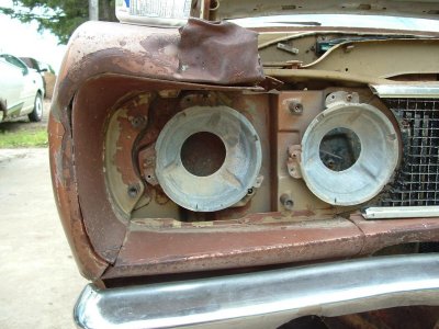

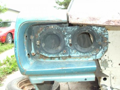

I have a 68 Coronet, couldn't find fenders, so I bought some 69's... WAY too different! Besides the obvious fender marker lights, the headlight area is recessed behind one headlight on the 68's, the 69's are flat. I've included some pics, the brown fender is the 68, while the turquoise is 69. If you absolutely desperate I suppose you could cut out the important parts from your originals, but its too much work. Good luck!
Ben
