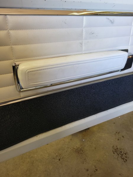

66 and 67 Coronet 440 WH and 67 Belvedere II RH used the 9" pads in post 12 with a chrome base.
I've had six of those unmolested.
I've never had a 66 Bel II but logically it should have used the same.
My 67 Belvedere convertible has 9” with chrome base. It may be a situation where the factory used whichever size was available.
