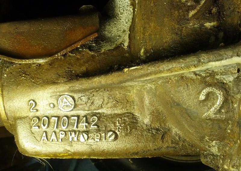

I am checking my rear differential options, below are the stamps on my existing diff.
I am thinking of going with a suregrip, 4.10:1
Is my existing 8-3/4 rebuildable with a replacement 3[SUP]rd[/SUP] member pumpkin in 4.10:1 flavor? If so, do I need to change out my rear axles also?

742 is, in my opinion, the best 8 3/4, and is what you have. However, 4.10:1 might not be the most street friendly gear...with a 28 inch tall tire, you would be around 3100 rpm to go 70. So, depending what you are trying to do, you might examine something more in the 3.55-3.91 range, plenty of go, and happier on the street.
As for yours being rebuilt, parts are readily available, check with doctor diff.
Stock axles would be fine.
Cone type Sure Grips can be machined to work very well so don't chunk it into the scrap pile before tearing it apart to see what the condition it's in. Clutch types have an aftermarket/nos parts available so they can be rebuilt and none of the 8 3/4 rears are really bad....even the 41 will do job.
