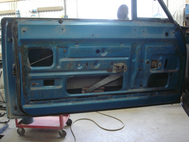

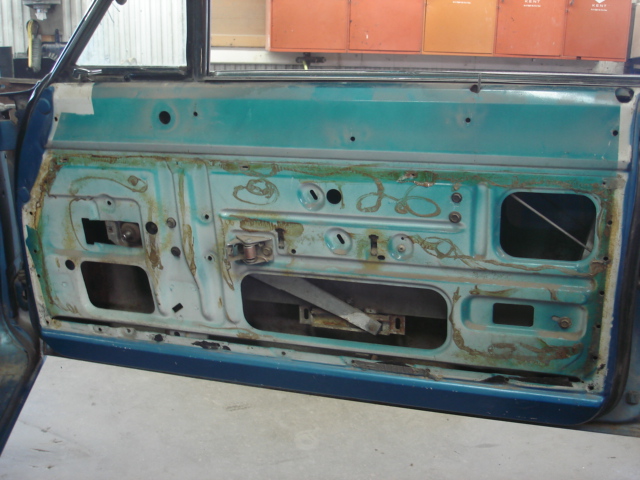

The '70 we are working on has two different doors. The R is what I'm guessing is a '68 and the L is the original. There are some differences like the lock rod hole. The stamping is a little different too.
L '70 door
R non '70 door
